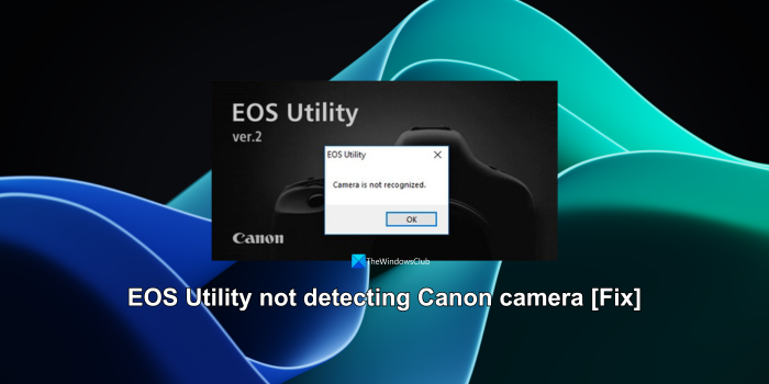

EOS Utility is an application developed and released by Canon to connect Canon cameras with a computer. It enables communication between the devices and lets us see images, download them onto a PC, shoot remotely, and control camera settings from the PC. The program is updated regularly with robust features to make the communication between the Canon camera and your PC easier. However, some users are complaining that EOS Utility is not detecting Canon camera. In this guide, we show you different methods you can follow to fix it.
EOS Utility – Camera is not recognized
Fix EOS Utility not detecting Canon camera on Windows PC
EOS Utility eases the connection between a Canon camera and a computer. If it fails to detect a camera, the following methods can help you resolve the issue and establish a connection.

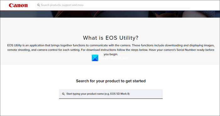

In case if there are multiple versions of EOS Utility are installed on your PC, you need to uninstall the older versions and keep the latest and updated ones for use. Having multiple versions running in the background can cause the issue. You can also remove all the EOS Utility apps, download the latest version from the Canon website based on your camera model, and install it to use. This should resolve the issue.

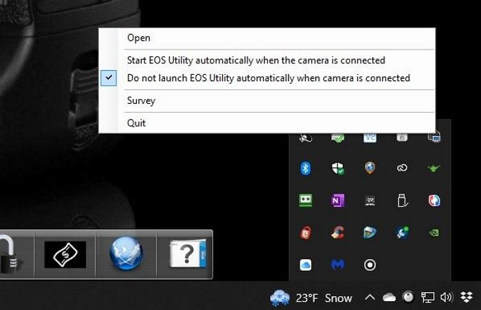

How do I start the EOS utility automatically when the camera is connected?
Open EOS Utility on your computer. Right-click on the EOS Utility icon in the System tray icons and click on Start EOS Utility automatically when the camera is connected. It enables the feature and makes EOS Utility launch automatically. You can disable it the same way.
