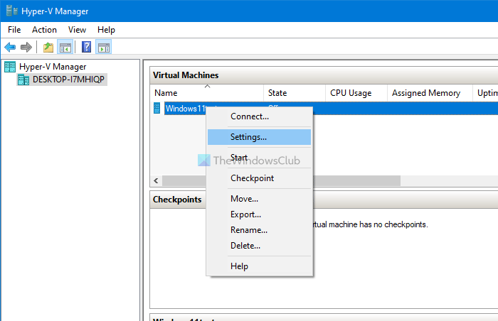

At first, you have to open the Hyper-V Manager on your computer. For that, search for “hyper-v manager” in the Taskbar search box and click on the respective search result. Here it shows all the virtual machines once you click on your computer name on the left side.
If you can see your virtual machine, right-click on it and select the Settings option.
Then, make sure your desired virtual machine is selected in the drop-down list. Following that, switch to the Security tab and tick the Enable Trusted Platform Module checkbox.
Click the OK button to save the change. After that, you can install Windows 11 without any problem.
