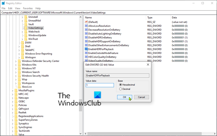

2] Modify the registry to enable the Stream HDR video switch
If you no longer have the option to restore Windows 10 to a previous version, you can try this solution. By modifying the registry, you can enable the Stream HDR video switch.
Here’s how:
Since this is a registry operation, it is recommended that you back up the registry or create a system restore point in case the procedure goes wrong. Once you have taken the necessary precautionary measures, you can proceed as follows:
- In the Run dialog box, type cmd and then press CTRL + SHIFT + ENTER to open Command Prompt in admin mode.
- In the command prompt window, copy and paste the command below and hit Enter.
reg add “HKCU\Software\Microsoft\Windows\CurrentVersion\VideoSettings” /v EnableHDRForPlayback /t REG_DWORD /d 1
- Exit the Command Prompt window, and restart your Windows 10 device.
On boot, you can check for updates to reinstall the newer Windows 10 version.
