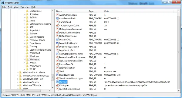

Click Start > Run Regedit > Navigate to the following key:
HKEY_LOCAL_MACHINE\SOFTWARE\Microsoft\Windows NT\CurrentVersion\Winlogon
In the right-side panel, change the value of Userinit to :
C:\WINDOWS\system32\userinit.exe
