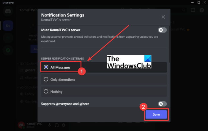

4] Change Server Notification Settings
The problem might be caused by your server settings. Make sure your default settings for server notifications are set to receive sound for all messages and not just when someone mentions you. This will ensure that you receive notification sounds on all messages. So, to resolve the problem, you will have to change server notification settings to get rid of this issue.
To modify your Server Notification Settings, here are the steps you need to follow:
- First, launch your Discord app.
- Now, you will see server icons at the left panel, right-click on the server you are facing the problem with. Note that you will have to repeat the entire process if you are experiencing this issue with multiple servers.
- Then, from multiple options, click on the Notification Settings option.
- From the Notification Settings dialog, set the Server Notification Setting to All Messages.
- Finally, press the Done button to apply new settings.
Similarly, you can change Server Notification Settings for all added servers on your account.
This method should fix the issue for you if your server notification settings were at fault.
