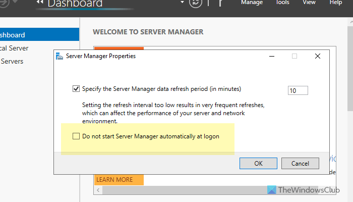

1] Using Server Manager option
To disable Server Manager at startup using Server Manager, follow these steps:
- Open the Server Manager on your computer.
- Click on Manage and select the Server Manager Properties option.
- Tick the Do not start Server Manager automatically at logon checkbox.
- Click the OK button.
If you want to enable Server Manager at logon, open the same wizard and remove the tick from the respective checkbox before clicking the OK button.

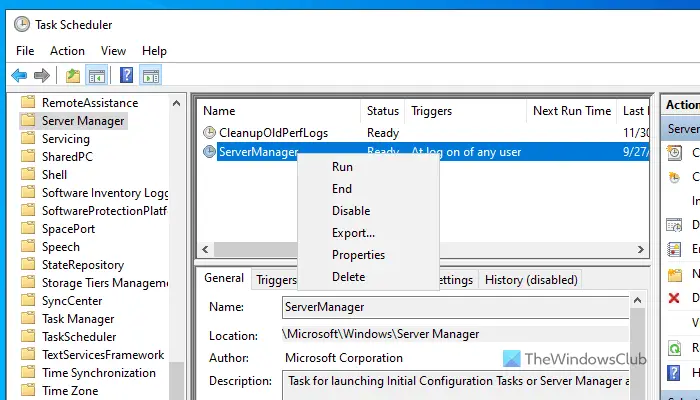

2] Using Task Scheduler
To stop Server Manager from opening at logon on Windows Server using Task Scheduler, follow these steps:
- Search for “task scheduler” in the Taskbar search box.
- Click on the individual search result.
- Expand the Task Scheduler Library.
- Go to Microsoft > Windows > Server Manager.
- Right-click on the ServerManager task and select the Disable option.
If you want to open the Server Manager again when you log in, you need to enable the task. To do so, open the Task Scheduler on your computer and navigate to the same path as mentioned above. Then, right-click on the same task and choose the Enable option.

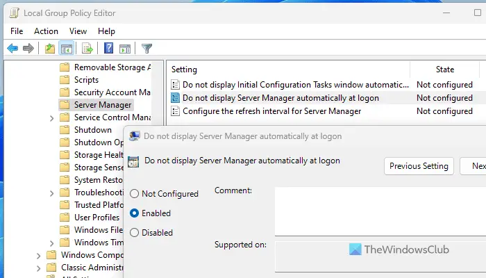

3] Using Local Group Policy Editor
To disable Server Manager at Windows Server logon using Group Policy, follow these steps:
- Type gpedit.msc and hit the Enter button.
- Navigate to Computer Configuration > Administrative Templates > System > Server Manager.
- Double-click on the Do not display Server Manager automatically at logon setting.
- Choose the Enabled option.
However, if you want to revert the change, you need to open the same setting in the Local Group Policy Editor, and select the Not Configured option.
