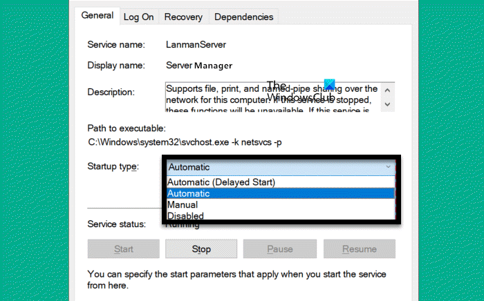

2] Make sure that the Server Manager Service is running
The Server Manager Service allows you to connect to the server in question and use the Server Manager application. In case, it’s disabled or is not running, you need to enable it in order to resolve the issue. Follow the steps mentioned below to do the same.
- Open Services app.
- Look for the Server Manager service, right-click on it, and select Properties.
- Change the Startup type to Automatic and click on Start.
- Finally, click on Ok.

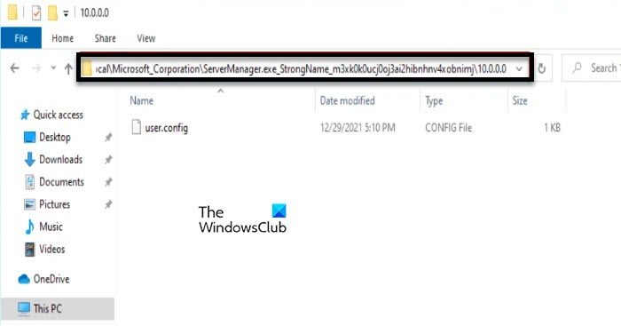

3] Recreate the user.config file
The user.config file contains all the changes that you have made to the user settings of the Windows Server Manager. In case, you made some changes due to which the application is not launching or working, you need to delete the file and allow it to get recreated. To do the same, follow the steps mentioned below.
- Open File Explorer by Win + E.
- Next up, navigate to the following location and delete the user.config file
C:\Users\YourUserName\AppData\Local\Microsoft_Corporation\ServerManager.exe_StrongName_m3xk0k0ucj0oj3ai2hibnhnv4xobnimj10.0.0.0user.config
- Finally, reboot your computer and let it be recreated.
You can now open the Server Manager console and check if the issue is resolved.
