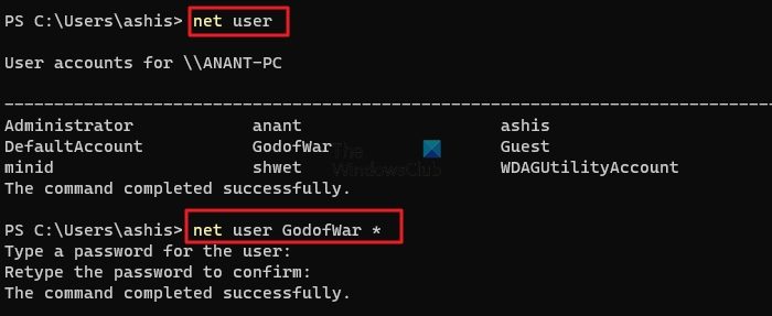

Disable login password using Command Prompt
You can also use the Command Prompt or Terminal on Windows to remove the Password; for this, follow these steps:
- Go to Windows search.
- Type CMD and right-click on it, and select Run as Administrator.
- Run this command to view all the accounts:
net user
- Next, run the below command to change the account password. Make sure to change the USERNAME field to your username.
net user USERNAME *
- Now press enter twice to remove Password.
So those were three quick ways to remove Windows passwords. However, among all the methods, I prefer using the second one, which is to switch to a local Windows account. But you are free to try any of the methods quoted above.
