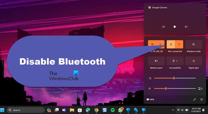

2] Make sure that you are not connected to a Bluetooth headset
Some of the users who were facing this issue were not able to hear the audio because the app was not producing any but because the audio was being redirected to a Bluetooth headset. In that case, we need to check if there is a Bluetooth headset connected to your computer. You can go to the Quick Settings and then disable the Bluetooth.

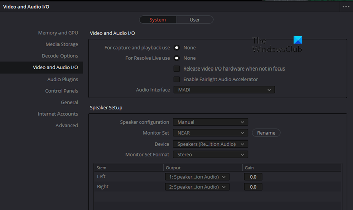

4] Change Audio Output Device
If the output device is not set correctly, you will not be able to hear anything. Ideally, DaVinci Resolve should automatically make changes to the settings to incorporate the correct device. Since we are facing an issue, we have to manually make the required changes for it to work. Follow the steps mentioned below to do the same.
- Open DaVinci Resolve.
- Now, go to Preferences.
- You then have to move to Video and Audio I/O.
- Finally, change the Device or Output Device and click on Save.
This should do the job for you.
