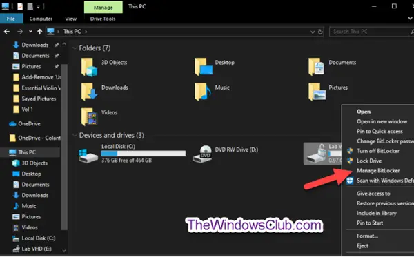

2] Add/Remove Manage BitLocker
You can add or remove the Manage BitLocker context menu from all unlocked drives encrypted by BitLocker for all users in Windows.
The procedure involved is the same as mentioned above. You just need to ensure that you are using the correct Registry files to add or remove this entry.

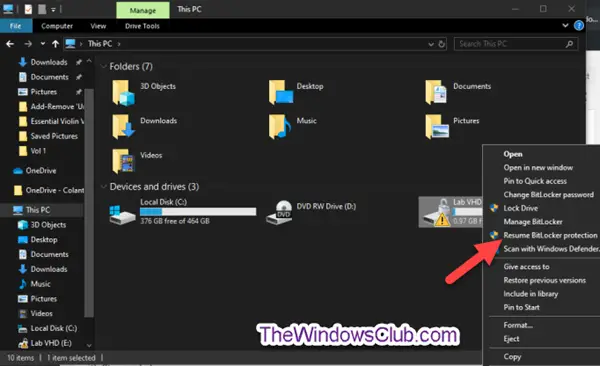

4] Add/Remove Resume BitLocker Protection
You can add or remove the Resume BitLocker protection context menu from all suspended drives encrypted by BitLocker for all users.
The procedure involved is the same as mentioned above in No 1. You just need to ensure that you are using the correct Registry files to add or remove this entry.

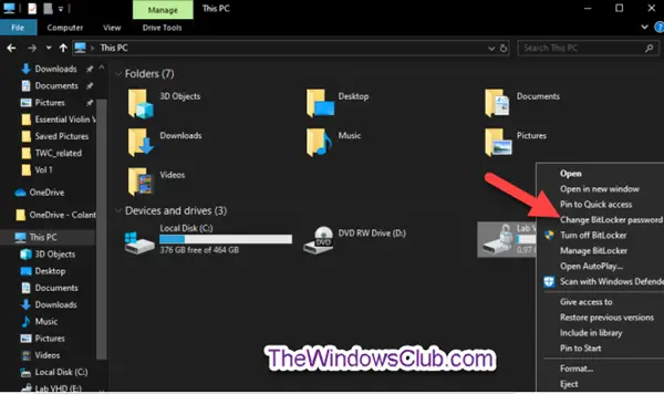

5] Add/Remove Change BitLocker Password
You can add or remove the Change BitLocker password context menu from all drives encrypted by BitLocker for all users in Windows 11/10.
The procedure involved is the same as mentioned above in No 1. You just need to make sure that you are using the appropriate Reg files to add or remove this entry.
When you remove the Change BitLocker password context menu, it will also gray-out Change password/PIN in the BitLocker button drop menu in the “Drive Tools” Manage tab of the ribbon. You will still be able to change the BitLocker password for a drive from the Control Panel.

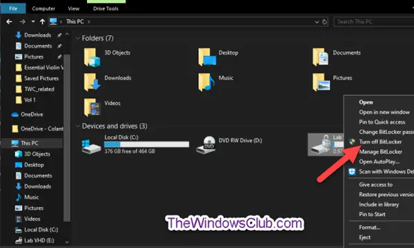

6] Add/Remove Turn off BitLocker
You can add or remove a Turn off BitLocker context menu for all fixed, OS, and removable drives encrypted by BitLocker for all users in Windows. When you turn off BitLocker for a drive encrypted by BitLocker, it will completely decrypt the drive.
You must be signed in as an administrator to be able to add, use, or remove the ‘Turn off BitLocker’ context menu.
The procedure is a bit different here.
To Add:
- Move the turn-off-bitlocker.vbs file which was downloaded into the C:\Windows\System32 folder.
- Double-click the .reg file to that adds this context menu to merge it.
To Remove:
- Double-click the .reg file that removes this context menu to merge it.
- Open the C:\Windows\System32 folder, and delete the turn-off-bitlocker.vbs file.

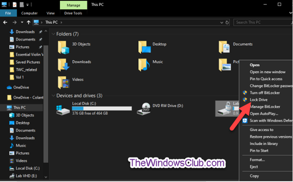

7] Add/Remove Lock Drive
The procedure here is as follows.
To Add:
- Move the lock-drive.vbs file which was downloaded into the C:\Windows\System32 folder.
To Remove:
- Double-click the .zip file that removes this context menu to merge it.
- Open the C:\Windows\System32 folder, and delete the lock-drive.vbs file.

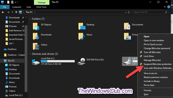

8] Add/Remove Suspend BitLocker protection
You can temporarily suspend or pause BitLocker protection at any time for an unlocked drive encrypted by BitLocker. When you suspend BitLocker protection, the drive remains unlocked and unprotected until you manually resume BitLocker protection.
You can add or remove Suspend BitLocker protection to the context menu of all unlocked drives encrypted by BitLocker for all users.
To Add:
- Move the suspend-bitlocker.vbs file which was downloaded into the C:\Windows\System32 folder.
To Remove:
- Double-click the .zip file to that removes this context menu to merge it.
- Open the C:\Windows\System32 folder, and delete the suspend-bitlocker.vbs file.
