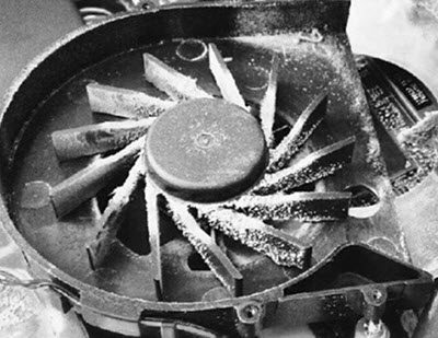

General tips to avoid computer fan running high speed all the time
Keep the computer clean. You can buy compressed air and use it on the computer motherboard occasionally. Remove, clean, and fix back Random Access Memory sticks (RAM). Always clean the inside of your computer after removing its power sources. That includes batteries if you are using a mobile device.
