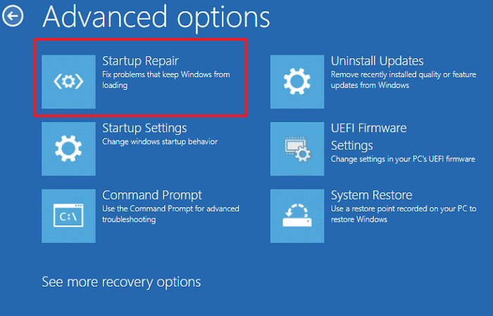

2] Run Startup Repair
You can also try running the Startup Repair. Startup Repair is a built-in tool in Windows computers that helps fix boot issues. You can access it in the Advanced Startup Options.
To run Startup Repair, you have to enter the Windows Recovery Environment. Force shut down your computer and start it by pressing and holding the Shift key.
If this does not work, you have to interfere with the normal boot process of Windows to enter the Recovery Environment. Here are the steps to do this:
- Press and hold the power button to shut down your computer.
- Turn on your computer. When you see the Windows logo or your computer manufacturer’s logo on the screen, immediately press and hold the power button to shut down your computer again.
Follow the above steps until your computer enters the recovery mode. You will see the Preparing Automatic Repair message on your screen. Now, you are in the Windows Recovery Environment.
Now, select Advanced options > Troubleshoot > Advanced options > Startup Repair.
Do not interrupt the process. Let the repair be completed. After the Startup Repair is completed, restart your computer and see if the problem is fixed.
