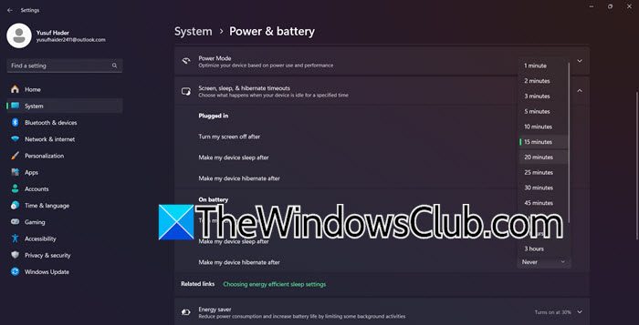

Additionally, you need to check if you have set the sleep timing to never. You can follow the steps mentioned below to do the same.
- Open Settings by Win + I.
- Go to System > Power & battery.
- Expand Screen, sleep, & hibernate timeouts.
- Check Make my device sleep after, if it is set to Never, change it to a time as per your need.
- Make sure to do it for Plugged in and On battery.
Once done, check if the issue is resolved.

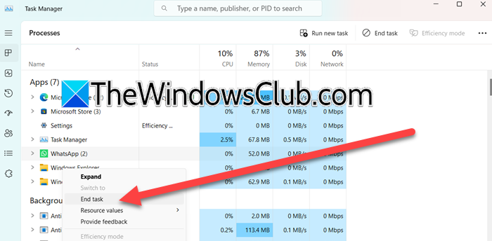

2] Check if there is a process still running
At times when we close a program, it continues to run behind in the background. Therefore, the system doesn’t sleep, just turns off the screen, and the notification keeps on popping up. So, let us just check if there is a program running in the Task Manager. To do so, you need to follow the steps mentioned below.
- Open the Task Manager by Ctrl + Shift + Esc.
- Now, go to the Process tab and check if there is a process that generates notifications such as Discord or WhatsApp running in the background.
- Then, right-click on it, and select End Task.
Make sure to kill the entire tree, ie. all the processes related to it. Once done, check if the issue is resolved.

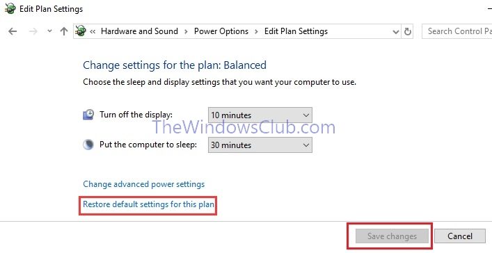

4] Restore default power settings
If you made changes to your power settings and encountered this issue, go ahead and restore it to default. Make sure to remember what changes you made so that you can replicate them if needed. To do so, follow the steps mentioned below.
- Open the Control Panel by searching it out of the Start Menu.
- Go to Hardware and Sound > Power Options.
- Click on Change plan settings.
- Now, click on Restore default settings for this plan.
- Click Yes to confirm.
Once done, put your system to sleep and then check if the issue is resolved.
