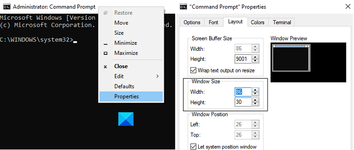

If you do not use the Windows Terminal app and instead use your preferrable profile (CMD or PowerShell) directly, worry not since you can change their individual default sizes as well. We will demonstrate how to do this with the Command Prompt, but the process can be replicated with PowerShell by following the same steps.
- Search CMD on the Start menu and click to run it as the administrator
- Right-click on the top slab
- Open CMD’s properties
- Visit the layout tab and adjust the Window Size
- Click on Ok to save the changes and you’ll observe that your terminal’s window size has been adjusted
To make the same change with your PowerShell, search for that instead and follow the same steps and prescribed above.
