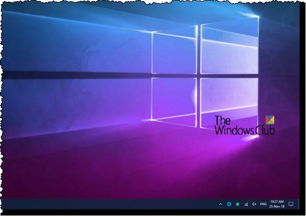

Is your computer monitor not displaying full-screen? If you have started seeing a black border around your computer display, then maybe you are wondering why this has happened and what you can do to fix this problem. The black bar could also appear on just the sides or bottom. This post will show you how to get rid of this black border or bar around the screen or monitor in Windows PC or Surface Pro device.
Black border or bar on Side around Screen in Windows 11/10 or Surface device

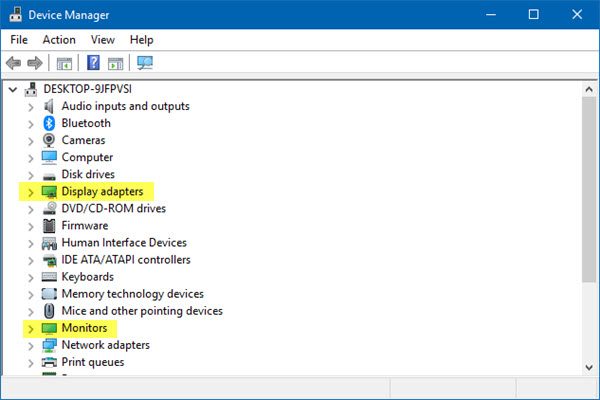

2] Update Graphics & Monitor Drivers
If you have not updated your drivers recently, then perhaps you could update the Graphics Driver and see if that helps you. If you recently updated your Graphics Drivers and then started facing this issue, maybe you need to Rollback the driver software.
If it does not help, you could visit the manufacturer’s website and download the graphics driver setup for your system. Then via the Device Manager uninstall this driver and then run the downloaded setup file to fresh install it. You will see this driver in Device Manager under Display adapters.
Also, scroll down to Monitors and expand the list. Here you will find your drivers for your monitor/s if you are using a desktop or an external monitor.
You may update them as well and see if it helps.
