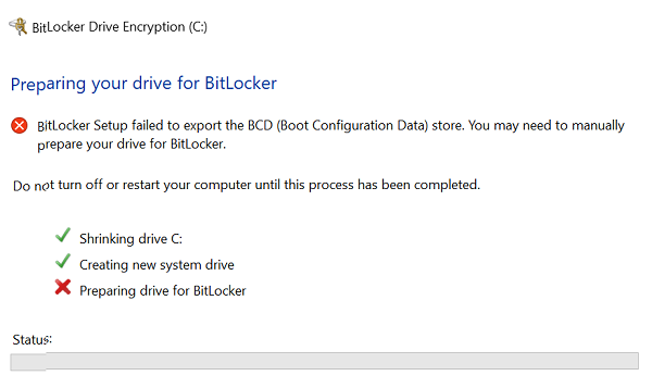

When using BitLocker Drive Encryption Tool, at times, users might encounter the following error on the system:
The BitLocker Setup failed to export the BCD (Boot Configuration Data) store, You may need to manually prepare your drive for BitLocker.
Why does BitLocker fail to export the BCD store?
The error occurs because the Boot Configuration Data (BCD) file is corrupted or misaligned. BitLocker must verify the BCD every time the system boots, and if entries point to the wrong partition, setup fails. A non-active system partition, a damaged MBR, or incorrect BCD paths can also cause this issue. This can also happen if Windows Boot Manager, Memory Tester, or Hibernate Resume entries point to the wrong drive.
