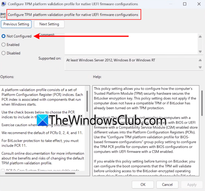

Remove the Group Policy configuration before installing the update. Follow these instructions:
- Open Group Policy Editor.
- Navigate to Computer Configuration > Administrative Templates > Windows Components > BitLocker Drive Encryption > Operating System Drives.
- Set the “Configure TPM platform validation profile for native UEFI firmware configurations” to “Not Configured“.
- Click Apply, then click OK to save changes.

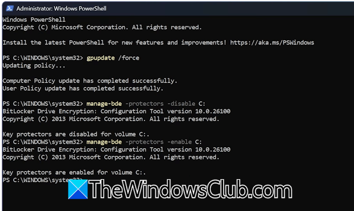

Now, launch Windows PowerShell as an administrator and run the following commands one by one. Press Enter after typing each command.
gpupdate /force manage-bde -protectors -disable C: manage-bde -protectors -enable C:
Replace the drive letter in the commands above with the one on which BitLocker is enabled. If it is enabled on C, use the commands as they are.
Now, you can install the update.

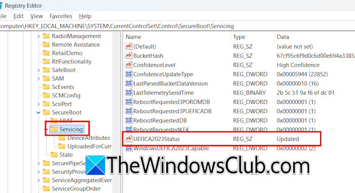

The new Secure Boot certificates may fail to apply when this BitLocker issue occurs. To verify the status of this process, check the UEFICA2023Status and UEFICA2023Error registry values. If the UEFICA2023Status registry value remains in an “In Progress” state over time and the UEFICA2023Error registry value shows any number higher than 0, then the update process has failed. Open the Registry Editor and navigate to the following path:
Computer\HKEY_LOCAL_MACHINE\SYSTEM\CurrentControlSet\Control\SecureBoot\Servicing
You will see any one or both of the above-mentioned registry values on the right side.
