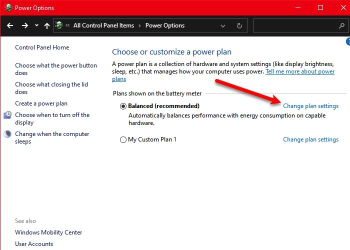

3] Restore default Power Settings
If you are still facing Battery Saver not working on Windows 11/10 error, try restoring default Power Settings.

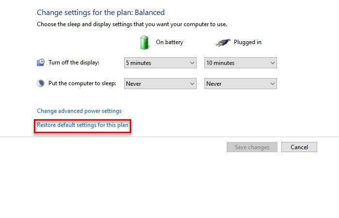

To do that, launch Control Panel by Win + X > Control Panel. Now, click Power Option and then “Change plan settings” of the selected Power option.
Click Restore default settings for this plan to restore your current plan, restart your computer, and check if it fixes the Battery Saver not working issue for you. Your issue will probably be fixed.
