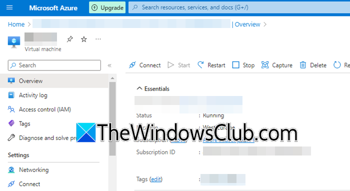

1] Check if the VM or its agent has started
First of all, we need to check if the virtual machine or the agent has started. Let us go ahead and open the Azure Portal from portal.azure.com. You can go through the list of virtual machines, select the problematic VM, and then select Overview. If the virtual machine is not running, click on the Start link.

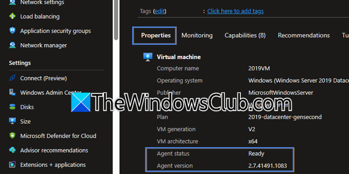

Also, go to the Properties tab and check the Agent status. If the status was Ready, but you encountered this issue, try going to learn.microsoft.com, as there is an issue with your virtual machine extension.

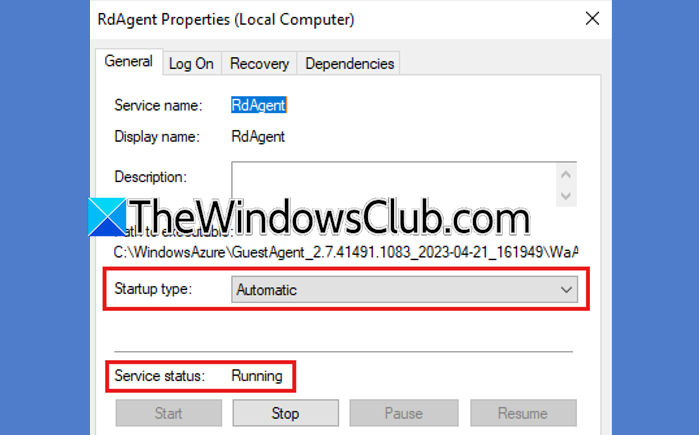

2] Check the Guest Agent services status
This method only works if you can connect to your virtual machine using RDP. If you can do that, then open the Services app, look for RdAgent, right-click on it, and select Properties. Now, check the Startup type to Automatic and make sure that the Service status is Running. If the service is not running, click on Start. Make sure to check the WindowsAzureGuestAgent service as well.
If the services don’t exist, the Guest Agent probably isn’t installed. You need to manually install the agent. Refer to the next solution for a similar approach.

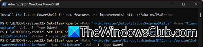

If this doesn’t work, you can try running the following commands in PowerShell (admin).
Set-ItemProperty -Path "HKLM:\System\Setup\Status\SysprepStatus" -Name "CleanupState" -Value 2 -Type DWord
Set-ItemProperty -Path "HKLM:\System\Setup\Status\SysprepStatus" -Name "GeneralizationState" -Value 7 -Type DWord
Set-ItemProperty -Path "HKLM:\Software\Microsoft\WindowsNT\CurrentVersion\SoftwareProtectionPlatform" -Name "SkipRearm" -Value 1 -Type DWord
Essentially, we are setting up CleanupState and GeneralizationState under SysprepStatus and SkipRearm under SoftwareProtectionPlatform as they are required when configuring SysPrep.
This should do the trick for you.

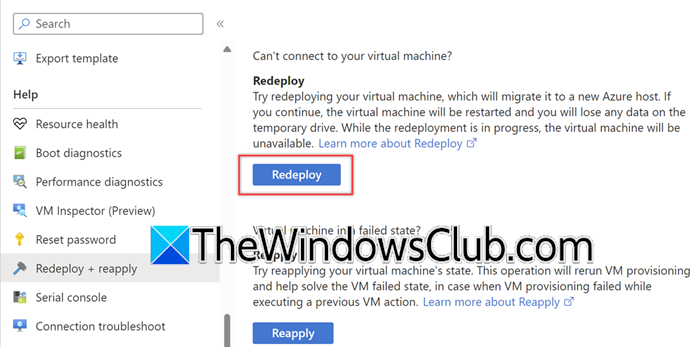

5] Redeploy and reapply VM
If you are still experiencing issues with the VM agent, we will proceed with redeploying the agent, which resolves underlying hardware or network issues by migrating your VM to a healthy Azure host.
Follow the steps mentioned below to do the same.
- Go to the Azure Portal.
- Now, you need to select the problematic virtual machine.
- Go to the Help section, select Redeploy + reapply, and then select Redeploy to migrate it to a new Azure host.
- You can also click on Reapply, as it fixes platform-level configuration drift without host migration.
Once done, reboot your virtual machine. Hopefully, this will do the job for you.
