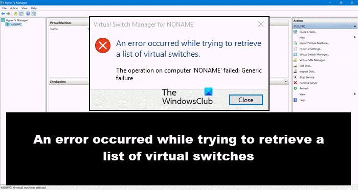

A Virtual switch helps in communication between different virtual machines and it forwards the traffic on the Internet. We can configure Private, Internal, and External Virtual Switches as per the requirement in Hyper-V. Sometimes due to problems on the host, accessing or installing a Network Switch is not possible. Some users faced a problem with the list of virtual switches in Hyper-V. In this article, we will learn what to do when you see An error occurred while trying to retrieve a list of virtual switches in Hyper-V.
An error occurred while trying to retrieve a list of virtual switches. The operation on computer failed: Generic failure.
To fix An error occurred while trying to retrieve a list of virtual switches message, follow the solutions mentioned below:

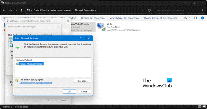

1] Enable Protocol in Hyper-V Extensible Virtual Switch
In this solution, we are going to enable protocol in a Hyper-V extensible virtual switch. The physical network card of our computer can access the Hyper-V Extensible Virtual Switch. The virtual machine can communicate with physical network interfaces through an external switch. We have to select the network adapter that will be used by that particular switch. Follow the below steps to do the same.
- Press Windows + R key to the open run dialog box.
- Type ncpa.cpl and press enter button.
- Right-click on the network card used for creating an external switch and then click Properties.
- Tick Hyper-V Extensible Virtual Switch and then click Install.
- Select Protocol and then click Add
- Select Reliable Multicast Protocol and then click OK
- Click the Close button.
Now, open Virtual Switch Manager in Hyper-V and try to create an external network switch.

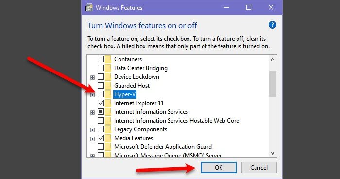

3] Reinstall the Hyper-V
If none of the above solutions work in your case, disable Hyper-V and then enable it, this way the problem can be solved. While disabling or enabling Hyper-V does not harm the virtual machine. It will be kept in Hyper-V Manager. Follow the prescribed steps to restart or reinstall Hyper-V on a Windows computer.
- Launch Control Panel from the Start Menu.
- Go to Programs > Programs & Features.
- Click on Turn Windows features on or off.
- Look for Hyper-V.
- Untick it and click Ok. You should ideally restart your computer before enabling the feature again.
After restarting, enable Hyper-V from the same panel and see if the issue persists.
