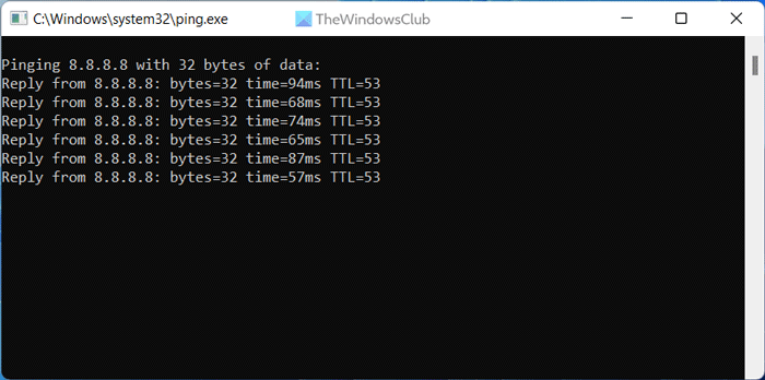

Therefore, follow these steps to check if you have a ping loss issue or not:
- Press Win+R to open the Run prompt on your computer.
- Type 8.8.8.8 -t and hit the Enter button.
- If it displays a continued result with ping time, it is fine.
However, if it is showing Request timed out or a similar error, you need to change the internet source immediately in order to troubleshoot this issue. You can use an alternate source such as a mobile hotspot, Ethernet, Wi-Fi, etc. However, you may need to restart the AMD app to get the job done.
