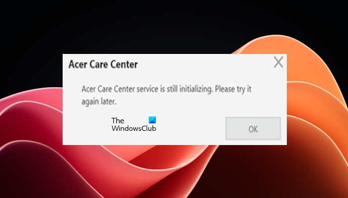

In this article, we will help you to fix the Acer Care Center Service is still initializing error message on your Windows PC. Usually, this error message appears when the Acer Care Center app does not start properly, possibly due to it being corrupted or outdated, or software conflicts.
Fix Acer Care Center Service is still initializing error
If you see the Acer Care Center Service is still initializing error message on your Windows 11/10 PC, use these suggestions to fix the issue:

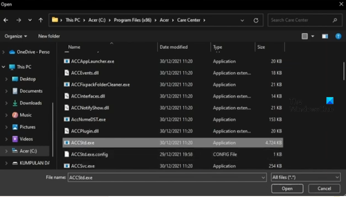

1] Restart the ACCStd.exe process
The ACCStd.exe process is related to the Acer Care Center and manages the Acer Care Center task. Therefore, we suggest you restart it and see if it works. Before restarting it, you have to terminate it in the Task Manager (if it is already running). Close the Acer Care Center completely, then open the Task Manager and locate the ACCStd.exe process.
Once you find it, right-click on it and select End task. Now, restart the ACCStd.exe process. The steps to do this are as follows:
- Open your Task Manager. Press Ctrl+Shift+Esc to launch it.
- Click on the Run new task option.
- In the Create new task window, browse to C:\Program Files (x86)\Acer\Care Center location and select ACCStd.exe.
- Now, click OK.
After performing the above steps, the Acer Care Center will be restarted. Check if the app works this time.

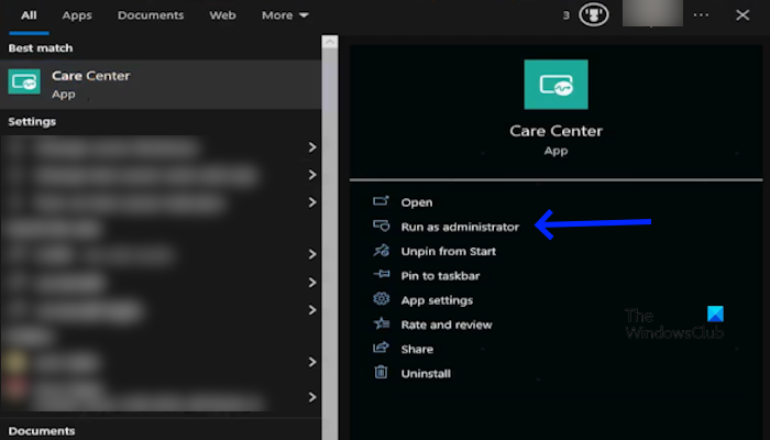

2] Run Acer Care Center as administrator
We also suggest you run Acer Care Center as administrator. This action will help to run this program function properly. First, close the Acer Care Center. To do so, right-click on the app and select Run as administrator.
If this works, you can make Acer Care Center always run as administrator. Use the following instructions:
- Right-click on the Acer Care Center icon on your desktop.
- Click on the Properties and select the Compatibility tab.
- Now, check the checkboxes for “Run this program as an administrator” and “Register this program for restart”.
- Click Apply and OK.
