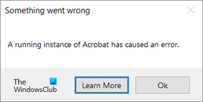

In this post, we will show you how to fix A running instance of Acrobat has caused an error message. Some Adobe Acrobat users have reported that while using the app, they get this error message. It is specifically triggered when users try to use some tools and features in Acrobat.
The primary cause of this error is the fact that there is already an Acrobat instance running and you try performing an operation outside Acrobat. Suppose, there is already an instance of Acrobat running but is busy or in a hang state. Now, when you try to perform a task like opening a PDF in Acrobat by double-clicking it from File Explorer, this error occurs. If you are also experiencing the same error, we got you covered with all working solutions. So, check out below.

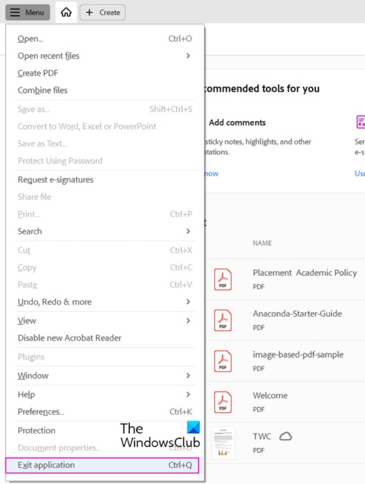

First, close the Acrobat Reader app. To do so, click on the Menu option and select the Exit Application option.
Or, simply press the CTRL + Q hotkey to close Acrobat.

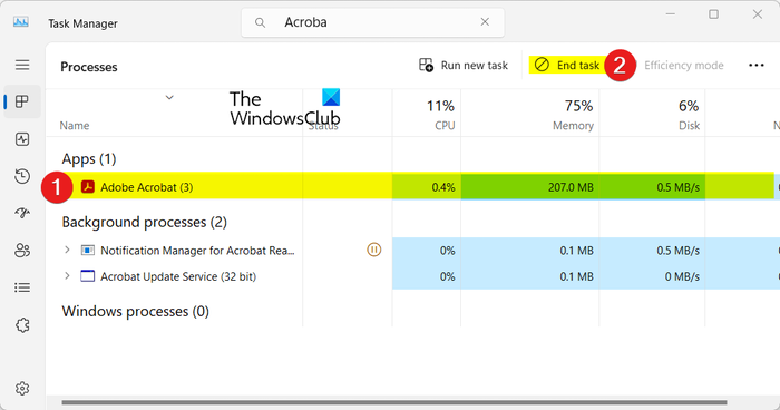

Now, open the Task Manager using CTRL+SHIFT+ESC and make sure there is no Acrobat process running in the background.
You can check under the Apps and Background processes sections. If there is an Acrobat process, select the process and press the End task button to close it.
Once done, restart the Acrobat Reader app and check if A running instance of Acrobat has caused an error is fixed.

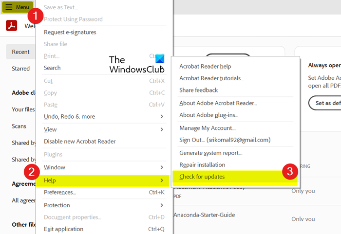

2] Make sure you are using the latest version of Acrobat
If you are using an outdated version of Acrobat, you are likely to run into errors and issues like this. Hence, if the scenario is applicable, update Acrobat Reader to its latest version and see if the error is gone. Here are the steps to do that:
- First, open the Acrobat app and click on the Menu option.
- Now, go to the Help option.
- Next, select the Check for updates option.
- Acrobat will now check for updates. If available, follow the prompted instructions to update Acrobat.
- Once done, relaunch Acrobat and check if the error is gone.

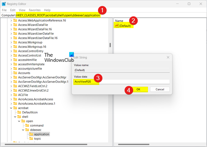

5] Try this Registry hack
The Adobe support team has recommended using a Registry hack to get rid of this error. It is as follows:
You can first back up your Registry to avoid problems in the future.
Now, close the Acrobat app.
Next, press Win+R to open the Run command box and enter regedit in it to open the Registry Editor app.
After that, in the address bar, enter the below address:
HKEY_CLASSES_ROOT\acrobat\shell\open\ddeexec\application
Now, right-click on the application key and choose the Export option to create a backup of this key.
Next, double-click on the Default key from the right-side panel.
In the Edit String window, enter AcroViewR20 in the Value data field. After that, press the OK button to save changes.
Finally, close the Registry Editor app and restart the Acrobat app to check if A running instance of Acrobat has caused an error is fixed.
