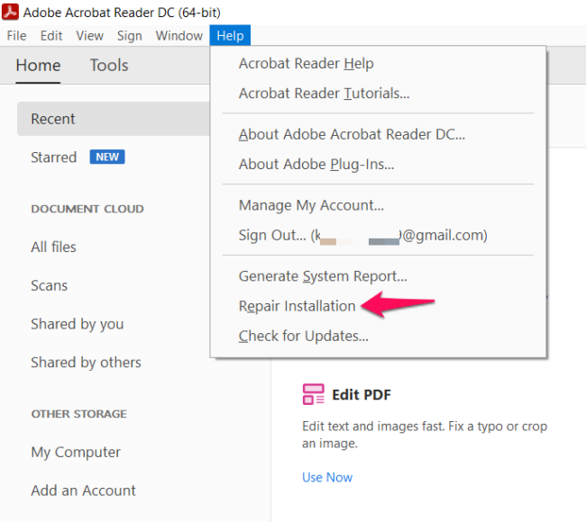

1] Repair the installation
The first solution on the list is to go through the repair process. The problem can occur due to a temporary glitch in Adobe Acrobat Reader DC. If this is the case, you can use the application’s repair functionality. Here’s how to do it.
- Launch Adobe Acrobat Reader DC on your Windows PC.
- Click on Help present at the top of the window.
- Choose the Repair Installation option from the context menu.
- Click on Yes to the prompt that pops up.
Wait until the process is complete. Once done, try to shut down your PC and check if the problem continues.

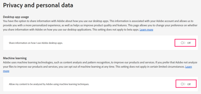

2] Uncheck the Desktop and app usage
The next thing you can try is to uncheck the Desktop and app usage. As it turns out, if Acrobat DC fails to send the data to the Adobe server, you will face the problem in question. Here are the steps you need to follow to get the work done.
- To begin with, open the Adobe login page on your Windows PC.
- Login with the same account that you are using on the application.
- Disable the toggle present next to Share information on how I use Adobe desktop apps and Allow my content to be analyzed by Adobe using machine learning techniques.
- Now, exit the window and restart your system.
Check if you are still facing the error message on shutdown. If yes, try the next solution on the list.

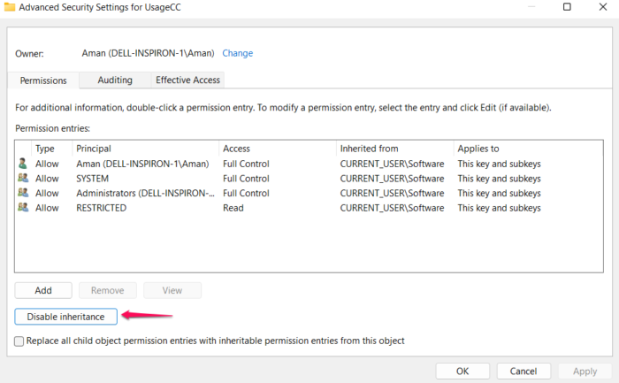

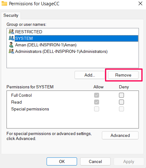

3] Change the Permission
For many users, the problem was fixed by changing the permissions of the UsageSS registry key. You can do the same and check if it fixes your problem. Below are the steps you need to follow.
Open the Run dialogue box by pressing the Windows + I shortcut key.
Type regedit and press the enter key.
Navigate to the below-mentioned location.
HKEY_CURRENT_USER\SOFTWARE\Adobe\CommonFiles\UsageCC
Right-click on the UsageCC folder and choose Permissions from the context menu.
Click on the Advanced option.
In the following window, click on Disable inheritance.
Click on Convert inherited permissions into explicit permissions on this object option.
Click on Apply > OK.
Now, select SYSTEM, and click on the Remove option.
Save the changes by clicking on Apply > OK.
Check whether the problem is fixed. If not, try the next solution on the list.

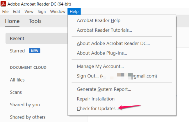

4] Update Acrobat DC
The problem can occur due to an outdated version of Adobe Acrobat DC. As a solution, you will have to download the latest update. Below are the steps to do it.
- Open Adobe Acrobat DC on your system.
- Click on the Help option at the top.
- Choose the Check for updates option.
The application will look for any available updates. If found, download it to fix the problem.
