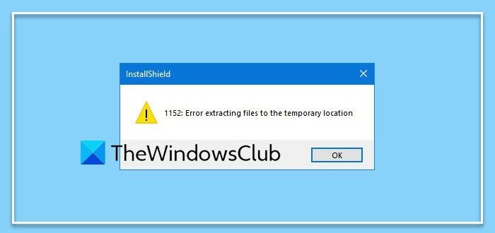

When you extract the contents of a file or when an installation is in progress, the extraction of its files to a temporary location fails, then this post may help you. Sometimes in a situation like this, you may receive an – InstallShield error saying — 1152, Error extracting files to the temporary location. The extraction will fail in the end. In this post, we will suggest some solutions to figure out how to fix it.
1152: Error extracting files to the temporary location
The 1152, Error extracting files to the temporary location error usually occurs if there are some ‘bad’ temporary files from previous failed installations. Cleaning up that folder and trying again is the way to go. It means if you are extracting a file to the same folder again, and again, it could be causing the issue, or the corrupt file in the Windows temporary folder is the problem. What you can do is:
