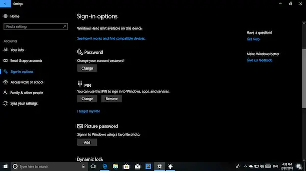

1] Remove and Change the PIN or the Password
Maybe there might be some conflicting issues with the PIN or the Password you have set for the User Account of your computer. So removing or changing the PIN or the Password that you use, can fix this error.
The steps to follow are:
- Remove the PIN
- Restart PC
- Set new PIN
- Restart PC and see.
If you face issues when changing the PIN, boot Windows in Safe Mode and then try.
