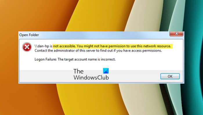

Many users use their Windows 11/10 computers to create and access their data on their servers via their network. Some users have been reporting an error that says that the server is not accessible. The whole error states,
\\server is not accessible. You might not have permission to use this network resource. Contact the administrator of this server to find out if you have access permissions. Logon Failure: The target account name is incorrect.
Today, we will be checking out how to fix this issue on your Windows 11/10 computer.
\\server is not accessible, You might not have permission to use this network resource

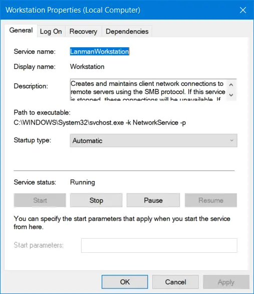

1] Check the status of the Workstation Service
Type, services.msc in the Start search box and hit Enter to open the Windows Services Manager.
Locate Workstation Service, and then double-click on it to open its Properties box.
Stop the Service and then Start it again. Or else right-click on it and select Restart.
Ensure that its Startup Type is set to Automatic.
