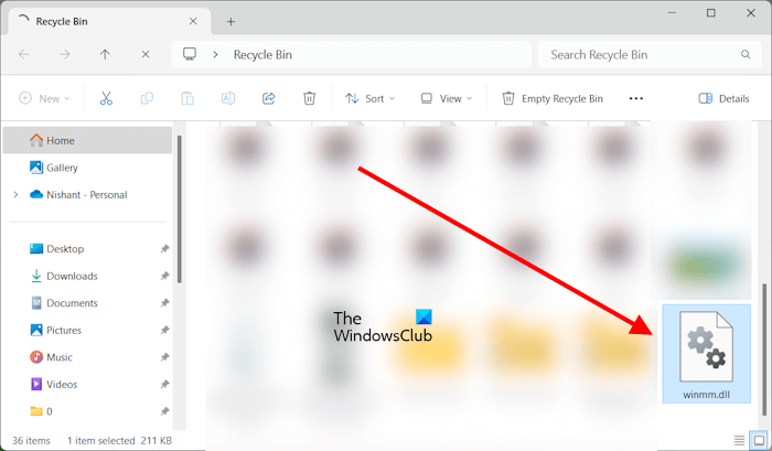

1] Restore the deleted winmm.dll file
There is a rare chance that you might have mistakenly deleted the winmm.dll file off your computer. If the deletion didn’t happen up to a month ago, it should still be in the Recycle Bin. To restore the file, open the Recycle Bin and search for “winmm.dll.” If it is there, right-click on the deleted file and hit Restore. This brings the file back to its original directory.

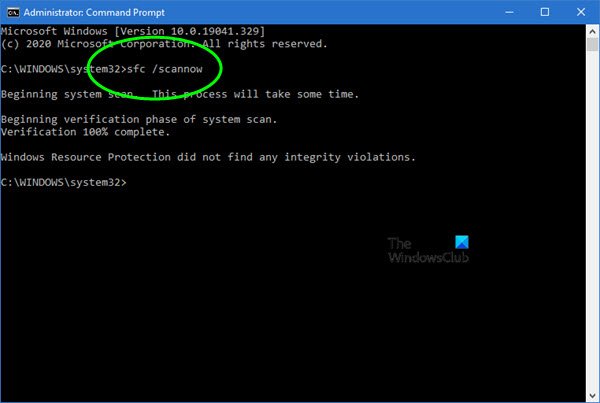

2] Run System File Checker
This is the best way to replace missing system DLL files.
Click on the Start button and enter cmd.
Right-click on Command Prompt and click on Run as administrator.
Enter the following command, and hit ENTER to run the System File Checker:
sfc /scannow
Restart your PC and see.
If it does not help, run DISM to repair a potentially corrupted system image.
In a Command Prompt window, type the following command and press ENTER to run it:
DISM.exe /Online /Cleanup-image /Restorehealth
On completion of the scan, restart your computer and see.

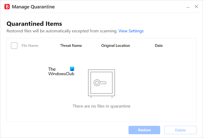

4] Check the Quarantine location in your antivirus
Antivirus software is good, as it protects our computers from various threats. However, sometimes, antivirus software blocks genuine programs and deletes the genuine files. Or it moves the genuine files to quarantine. Such types of flags are false positive flags that can be avoided.
This can be the case with you. Your antivirus software might have quarantined the winmm.dll file. You can check this in the quarantine location of your antivirus. Open your antivirus software and check if the winmm.dll file exists at the quarantine location. Different antivirus software have different user interfaces. Therefore, depending on your antivirus software, you need to refer to the support website of your antivirus to know how to access or view the quarantined files.
If the winmm.dll file is quarantined by your antivirus, restore it. However, your antivirus can again move the file to the quarantine location. Therefore, to avoid this issue again, whitelist the winmm.dll file in your antivirus. Again, you need to refer to your antivirus website to know the exact process to whitelist files and programs.
If you are using free antivirus software, you can either whitelist the winmm.dll file or switch to another free antivirus.

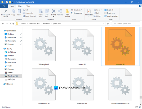

7] Copy the file from another computer
If you have a healthy system on which your Windows Media Player and other programs all run smoothly without errors, you can get the winmm.dll file from the computer. For this technique, start by inserting a removable storage drive (flash drive, hard drive, etc.) into the health PC.
Next, navigate to the C:\Windows\System32 (or SysWOW64) directory of the healthy PC. Find the winmm.dll file in this folder and copy it to the storage drive. Ensure never to hit cut. Paste it in the USB drive and connect the USB drive to the PC you want to repair.
Now, copy or cut the winmm.dll file from the external drive and paste it in C:\Windows\System32.
The final step is to re-register the dll file.
