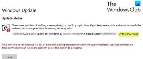

If you’re encountering the error code 0x800700d8 when trying to install certain updates or after a failed upgrade to Windows from an older version, then this post is intended to help you. In this post, we will identify the possible causes as well as provide the appropriate solutions you can try to remediate the issue.

Fix Windows Update error 0x800700d8
If you’re faced with this Windows Update error 0x800700d8 issue, you can try our recommended solutions below in no particular order and see if that helps to resolve the issue.
