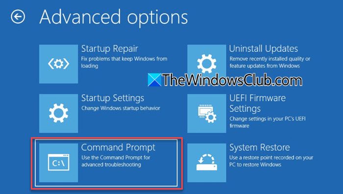

Press and hold the Shift key, click the Power icon in the bottom-right corner of the login screen, and select Restart. Windows will start in the Recovery Environment (WinRE).
Under ‘Choose an option’, select Troubleshoot > Advanced options > Command Prompt.

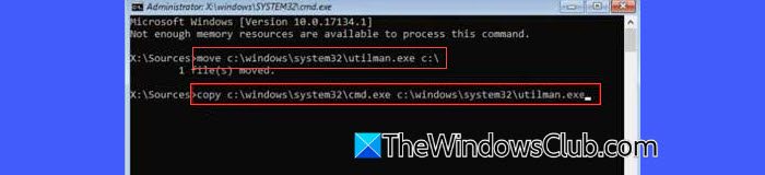

Command Prompt will open with administrator privileges. Type the following commands in the Command Prompt window and press Enter after each command:
move c:\windows\system32\utilman.exe c:\
copy c:\windows\system32\cmd.exe c:\windows\system32\utilman.exe
Once the commands are executed, execute the following command:
shutdown /r /t 0

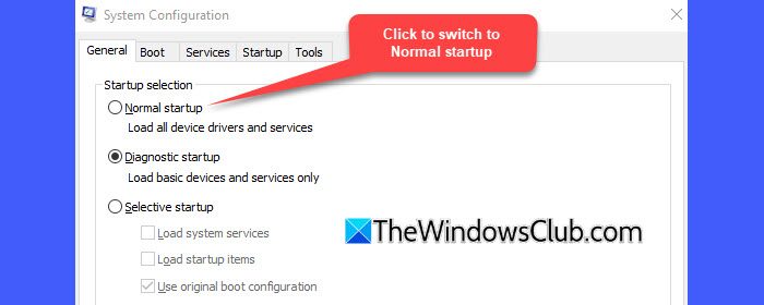

In the Command Prompt, type msconfig, and press the Enter key. System Configuration window will appear.
Go to the General tab and select Normal startup under Startup selection. Click Apply, then click OK to confirm the changes.

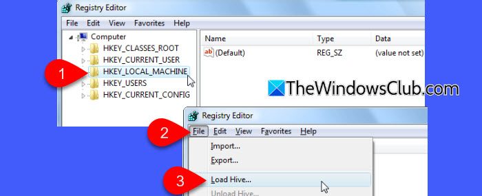

2] Disable PIN-only sign-in via Regedit in Windows Recovery mode
This method involves using the Registry Editor in Recovery Mode to disable the PIN-only sign-in policy.
Note: Proceed with caution when editing the registry in Recovery Mode. Making incorrect changes can cause further issues or render your system unbootable. Ensure you understand the steps thoroughly before proceeding.
Boot your system into Recovery mode as explained above. In the Recovery menu, select Troubleshoot > Advanced options > Command Prompt.

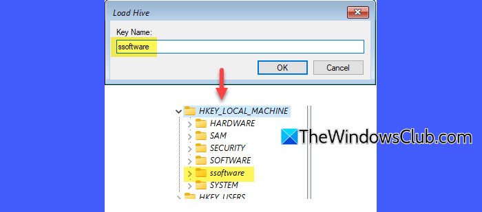

In the Command Prompt, type regedit and press Enter. This will open the Registry Editor, without registry hives (this is the default behavior of RegEdit in WinRE).
To load the registry hives, select HKEY_LOCAL_MACHINE in the left pane, then click on the File menu and select Load Hive…
Navigate to the drive where your Windows installation is located (this is usually not C:\ in WinRE; it might be labeled as another letter, like D:\ or E:\.) Next, navigate to [Drive letter]:\Windows\System32\Config and select the SOFTWARE hive file. When prompted, give the hive a temporary name (e.g., ssoftware).

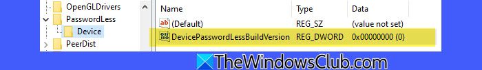

Next, expand the loaded hive and navigate to the following path:
HKEY_LOCAL_MACHINE\ssoftware\Microsoft\Windows NT\CurrentVersion\PasswordLess\Device
Locate the key DevicePasswordLessBuildVersion and change its value from 2 to 0.
This disables the ‘Require Windows Hello’ feature that enforces PIN-only sign-in.

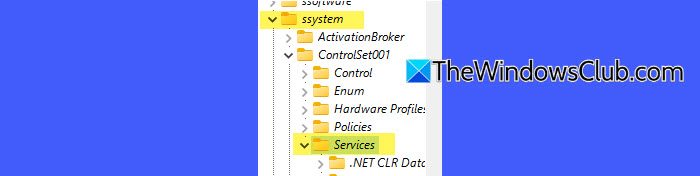

Reboot to the WinRE Command Prompt and open Registry Editor again. This time, load the SYSTEM hive (e.g., as system).
Next, navigate to the following key:
HKEY_LOCAL_MACHINE\ssystem\ControlSet001\Services
For each of the following services, edit the Start key value as follows:

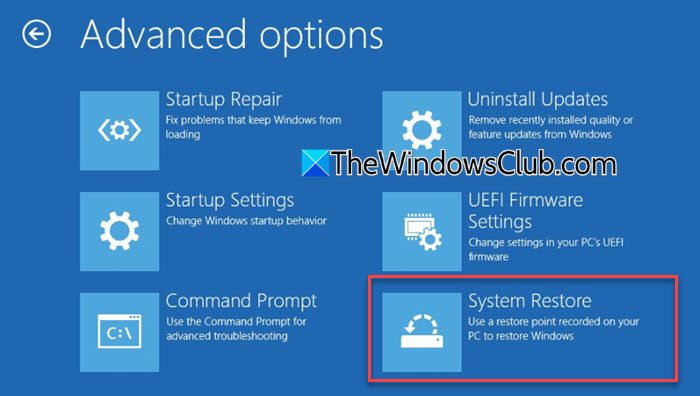

3] Use System Restore in Recovery Environment
If you have a restore point prior to the occurrence of the issue, you can effectively restore normal system behavior.
At the login screen, click the Power button, hold Shift, and select Restart. Alternatively, boot using installation media, select your language preferences, and click Next.
Click Repair your computer in the lower-left corner.
Once you enter WinRE, select Troubleshoot > Advanced options > System Restore.
The System Restore window will open, allowing you to select a restore point.
Choose a restore point before enabling Diagnostic Startup, click Next, and follow the on-screen instructions to complete the restoration process.
After the restoration, restart your PC and check if the PIN login works.
