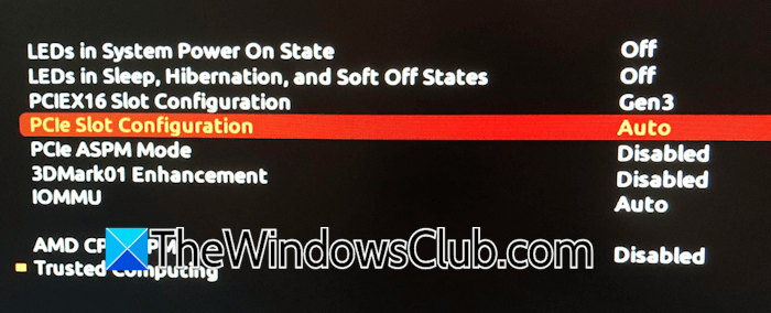

5] Change the PCIex16 slot configuration in BIOS
The PCIe slot configuration setting in BIOS allows you to change the PCIe generation. By default, it is set to Auto. You can change this from Auto to a specific PCIe generation in certain cases. For example, if you have a newer motherboard with the latest generation PCIe slots but are using an older graphics card or an older PCIe Riser cable, you can manually set the PCIe version to an earlier generation, such as PCIe x16 Gen 3, for improved compatibility.
Different motherboards have different settings to change this option. Refer to your motherboard user manual for the steps to change this setting. In most cases, setting it to Gen 3 resolves the issue.
If you cannot boot into BIOS, remove your graphics card, then start your computer with the integrated GPU.
