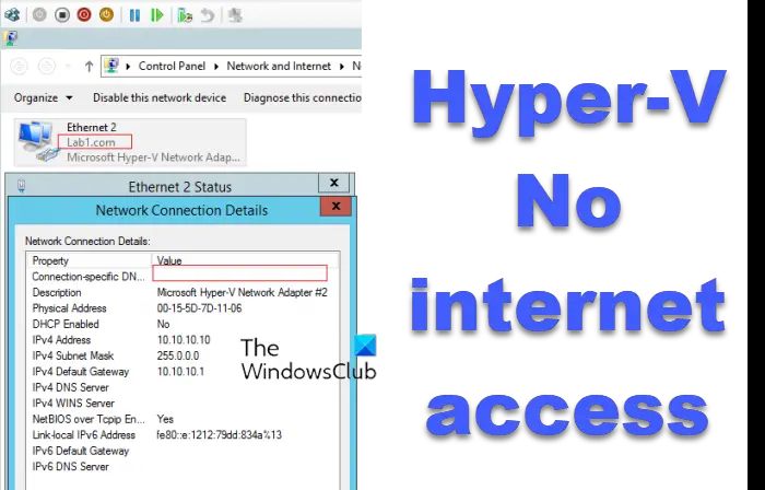

If Hyper-V Network adapter is not connected & you see No internet access message, then it is caused due to misconfiguration of the Virtual Machine. Some people are reporting that they are not able to access the internet using the Virtual Machine they created and the adapter says “Not connected” in the Control Panel. In any case, this post will help you
Windows Hyper-V Network adapter not connected

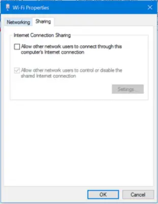

Open the Network and Sharing Center from the Control Panel. Select the adapter for your Hyper-V Virtual Machine. Right-click on it and select Properties.
Under the tab of Sharing, check the box that says, Allow other network users to connect through the computer’s internet connection.
Select OK.
Run your Virtual Machine again, and your issue will be fixed now.
