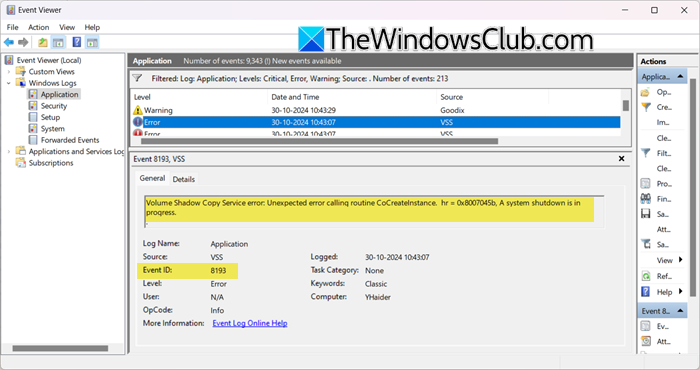

When checking the application log in the Event Viewer, I stumbled upon an Event ID 8193, which implies that there is some issue with the VSS which can hinder in the backup and recovery process of the machine. This might not seem like an important issue, but it can be if your system crashes. In this post, we will talk about VSS Error, Unexpected error calling routine CoCreateInstance and see how you can resolve it.
Volume Shadow Copy Service error: Unexpected error calling routine CoCreateInstance. hr = 0x8007045b, A system shutdown is in progress.
Fix VSS Error, Unexpected error calling routine CoCreateInstance, Event ID 8193

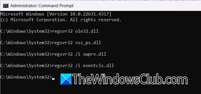

2] Re-register VSS Components
There is a possibility that VSS refuses to work because of a glitch and in order to resolve it, we will manually register server. DLL files that are essential for the Volume Shadow Copy Service to function to ensure that all necessary components are properly registered and available for the VSS to use. In order to do so, you first need to open Run, type “cmd”, and hit Ctrl + Shift + Enter. You will get a UAC pop-up, click on Yes when prompted.
Now, run the following commands one by one.
regsvr32 ole32.dll regsvr32 vss_ps.dll regsvr32 /i swprv.dll regsvr32 /i eventcls.dll regsvr32 es.dll regsvr32 stdprov.dll regsvr32 vssui.dll regsvr32 msxml.dll regsvr32 msxml3.dll regsvr32 msxml4.dll
Finally, reboot your computer and then check if the issue is resolved.

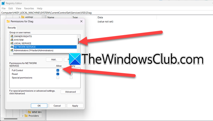

3] Check Network Service Account Permissions
There is similar error, with the same Event ID: 8193, which says “Volume Shadow Copy Service error: Unexpected error calling routine. Access is denied“. This error is usually caused due to the lack of permission to the Diag key. We suspect that the issue that we are facing can also be a product of the same problem. Therefore, we are going to make some changes to the registry in order to resolve the issue. However, before making any changes, we recommend you take a backup of your registry.
Once done, follow the steps mentioned below.
- Open Registry Editor by searching it out of the Start Menu.
- Now, navigate to
Computer\HKEY_LOCAL_MACHINE\SYSTEM\CurrentControlSet\Services\VSS\Diag - Right-click on the Diagfolder and select Properties.
- Now, select NETWORK SERVICE option from the Security tab, tick the box associated with Full Control, and click on OK.
- You can close the Registry Editor.
Finally, reboot your computer and see if the issue is resolved.
