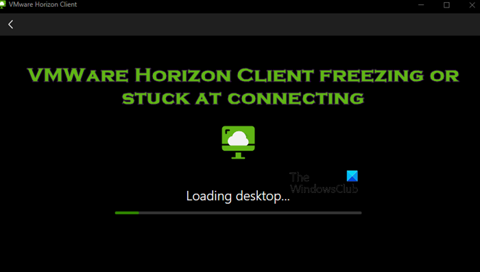

When trying to connect to a VDI using VMWare Horizon Client, we have noticed that the app sometimes freezes, after or before authentication and is stuck at the connecting stage. In this post, we will talk about this issue and see what you can do if the VMWare Horizon Client is freezing or is stuck connecting.
Fix VMWare Horizon Client Freezing or Stuck at connecting
If the VMWare Horizon Client is freezing or stuck at connecting on Windows 11/10, execute the solutions mentioned below:
