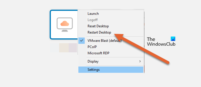

2] Restart Remote Desktop
If your Internet connection is fine, you must reboot your VDI. If the VDI didn’t start correctly, rebooting it will do the trick. Just click on the three vertical dots associated with the connected remote computer and click on Restart Desktop. Wait for a couple of minutes, and then try connecting to the desktop. Hopefully, it will work like a charm.

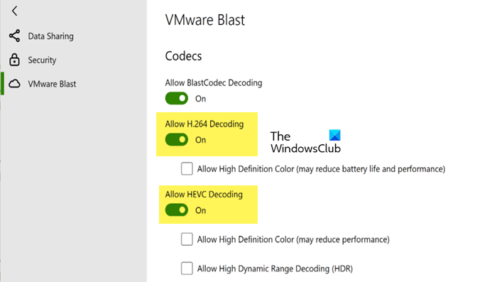

3] Disable H.264 decoding AND HEVC
H.264 is a codec optimized for playing multimedia content and enjoys widespread support from most client hardware. Low-powered thin clients may experience better frame rates when using this codec. On the other hand, HEVC (High-Efficiency Video Coding) is also optimized for multimedia content but requires more specialized hardware to function efficiently. That’s why, for many users, these features just don’t work. Enabling them can put a lot of load on their computer and can even stop Horizon Client from launching on their system. Hence, we are required to disable them. Follow the steps mentioned below to do the same.
- Open Horizon Client.
- Click on the cog to open its Settings.
- Then, go to VMWare Blast and disable the toggle for Allow H.264 Decoding and Allow HEVC Decoding.
Finally, close the settings panel and check if the issue is resolved.

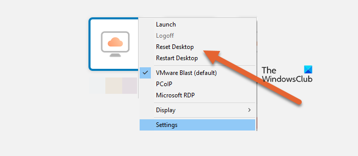

4] Reset the Remote Desktop and Published Application
If you have made some configurations to your VDI that are a little problematic or are conflicting with your system, the remote desktop will fail to open. Since it is very difficult to point out a single mistake, we are better off just resetting the VDI. It’s not going to remove your personal information unless they are saved. So, to reset your VDI, all there you need to do is right-click on the virtual desktop and click Reset Desktop.

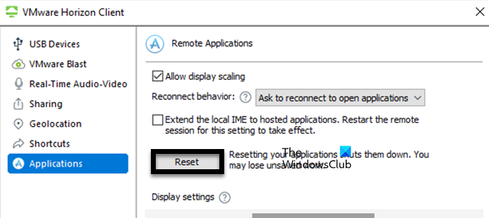

Resetting published applications will close all open applications and any unsaved data will be lost. To do so, go to the Settings of VMWare Horizon Client and click on Applications > Reset. This should do the trick.

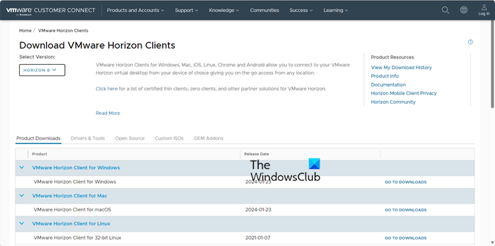

6] Reinstall Horizon Client
If all else fails, our last resort is to uninstall VMWare Horizon Client and install a fresh copy of the same. Make sure to install the latest version of Horizon Client from customerconnect.vmware.com.
