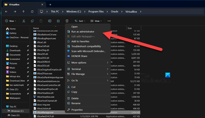

3] Run the VBoxManage.exe file with administrative privilege
If the VBox is still stuck while importing virtual appliances, it is possible that you aren’t running the VBoxmanage.exe file with all the required privileges. A potential solution in this case would be to run the VBoxmanage.exe file as an admin. You can right-click on the file and select Run as administrator to do the same. The file will be located at – C:\Program Files\Oracle\VirtualBox.

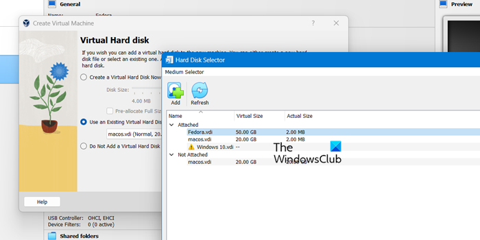

4] Creating a new virtual machine using an existing disk image
If you are encountering the VBOX_E_FILE_ERROR (0x80BB0004) error when trying to import the Appliance OVA file into VirtualBox then creating a new Virtual Machine will be helpful to resolve this error.
Follow the prescribed steps to create a new Virtual Machine:
- First, open Oracle VM VirtualBox and click on the New tab to create a new virtual machine.
- Write the Virtual Machine name, then select the Type and Version of the operating system and click on the Next button. You can skip the ISO part.
- You can select required the memory size using the toggle and click Next to continue.
- Finally, choose to Use an existing virtual hard disk file, click the folder icon, and browse to the location of the .vdi file.
After creating the new virtual machine, see if the issue has been resolved.

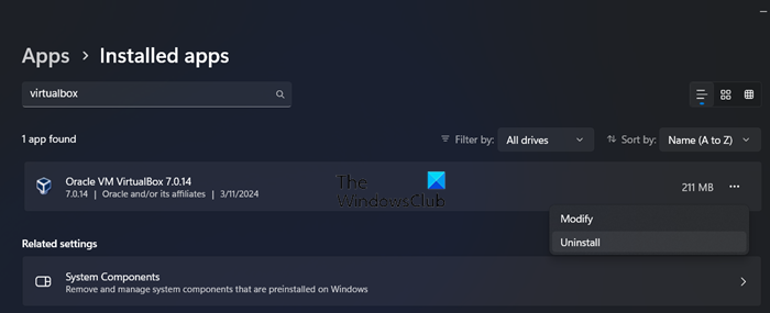

5] Reinstall Oracle VirtualBox
If all else fails, your last resort is to reinstall the Oracle VirtualBox as there is a high chance that the existing copy is corrupted. So, uninstall the program, reboot your computer, and then install a fresh copy from virtualbox.org. Hopefully, this will do the job.
