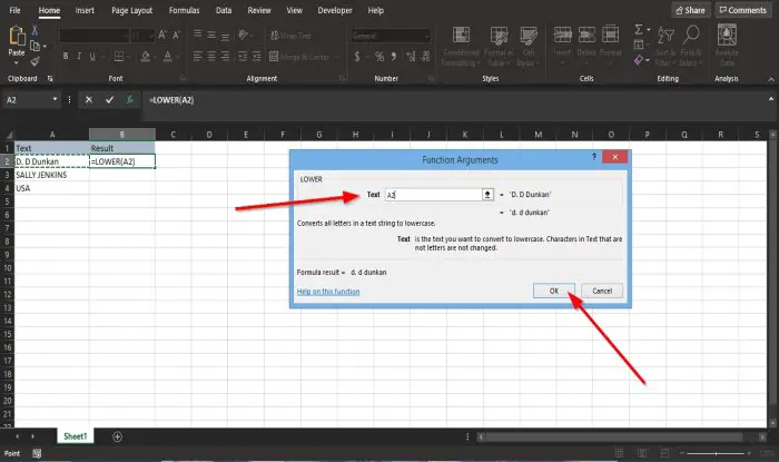

Use Lower function to convert text into lowercase in Excel
Open Excel.
Write uppercase text into the cell or cells.

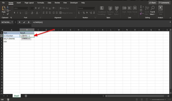

Type into the cell where you want to place the result, =LOWER(A2).
A2 is the cell that contains the text you want to convert to lowercase.

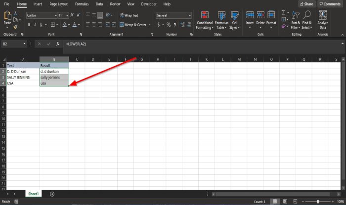

Press Enter, and you will see the result.
To get the other results, drag the fill handle down.
There are two other methods to use this function.

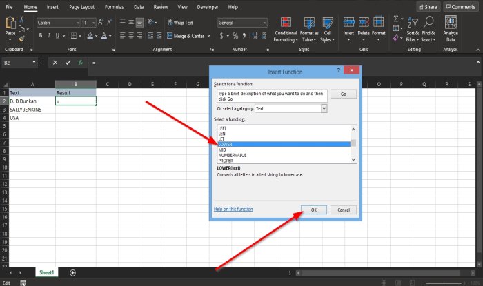

Method one is to click the fx button on the top left of the worksheet.
An Insert Function dialog box will pop up.
Inside the dialog box in the Select a Category section, select Text from the list box.
In the Select a Function section, choose the Lower function from the list box.
Then OK.
A Function Arguments dialog box will appear.
Inside the dialog box, enter A2 in the Text box.
Then OK.

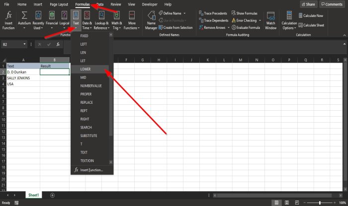

Method two is to click the Formulas tab and select the Text button in the Function Library group.
Select the Lower function from the list.
A Function Arguments dialog box will pop up.
Follow method one for the steps for the Function Arguments dialog box.

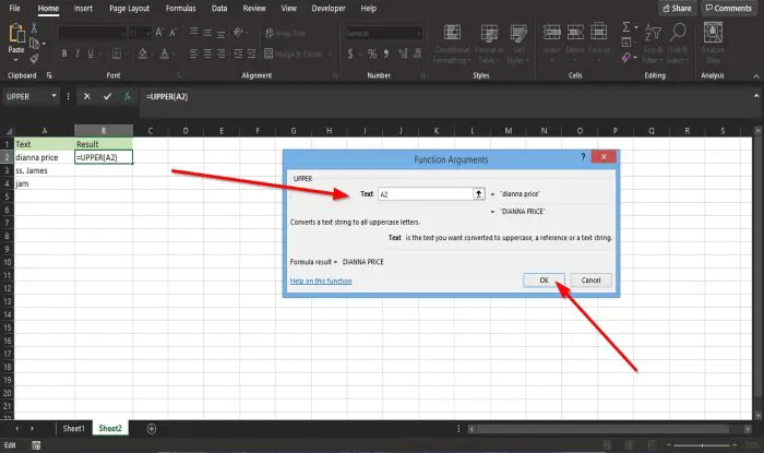

Use Upper function to convert text into uppercase in Excel
Enter lowercase text into the cell or cells.

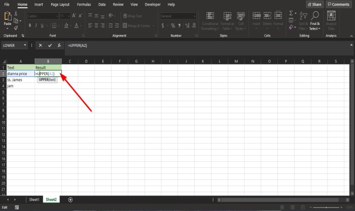

Type into the cell where you want to place the result, =UPPER(A2).
A2 is the cell that contains the text you want to convert to uppercase.

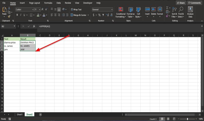

Press enter you will see the result.

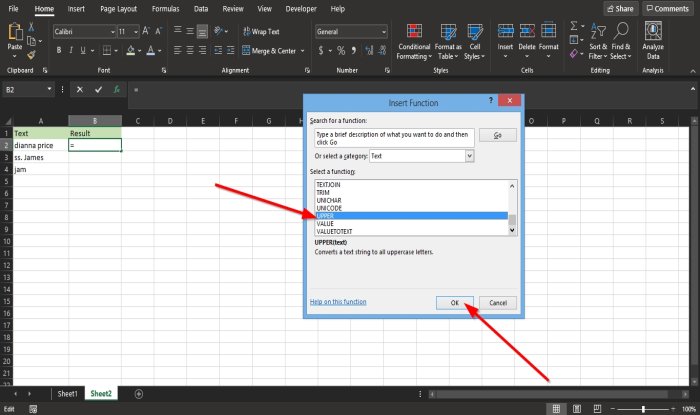

An Insert Function dialog box will appear.
In the Select a Function section, choose the Upper function from the list box.
Then click OK.

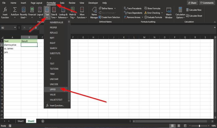

Select the Upper function from the list.
