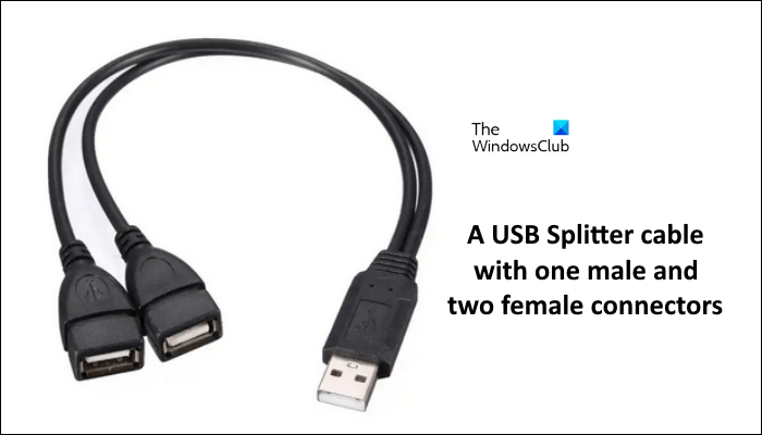

As the name implies, a USB Splitter cable is a type of USB cable that is split into multiple USB connectors. Usually, a USB Splitter cable is split into two USB connectors. But you may also see some USB Splitter cables with more than two USB connectors.
One end of a USB Splitter cable has a male USB connector and the other end is split into multiple USB connectors. The split ends of a USB Splitter cable can have different or the same types of USB connectors, like both female USB connectors, one male and one female USB connector, etc.

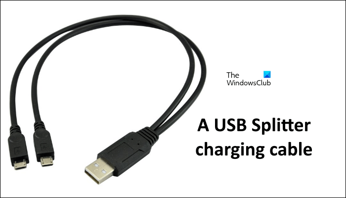

Some USB Splitter cables are manufactured only for charging purposes. These types of USB Splitter cables have a male USB port at one end and the other end is split into the USB ports like Micro USB port, USB C port, etc.

Let’s start with the design of these two electronic gadgets. A USB Splitter cable has a simpler design. One of its ends has a USB male connector and the other end is split into two or more USB connectors. To use a USB Splitter cable, connect its male connector to your computer, and then you can connect your USB devices to your computer via the female connector on the other end of the USB Splitter cable.

The split end of the USB Splitter cable has both female USB connectors or a male and a female USB connector. Some USB Splitter cables are made to charge devices. These types of USB Splitter cables contain charging ports at the split end, like a Micro USB port.
