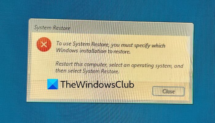

There are situations where you need to perform the System Restore operation. But at times you may face an error – To use System Restore, you must specify which Windows installation to restore. This error is caused due to corrupted files in the system. Because of this error, you are not able to perform the system restore and this can be a hurdle to proceed further.
There are scenarios where you cannot boot up once you encounter this error. This article provides solutions to solve this error. So, first, let us see what causes “To use System Restore you must specify which Windows installation to restore” error-
- Any of your previous actions might have corrupted System files and may cause this error.
- As BCD (Boot Configuration Data) is used to stores all data – it could be BCD Corruption

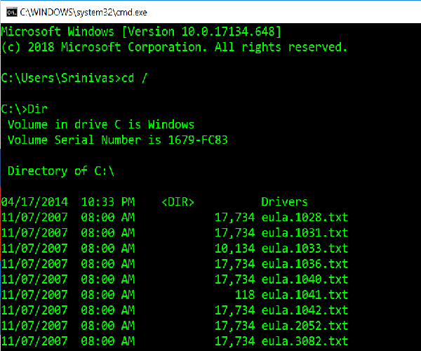

Type the following commands one by one, to know your system’s drive.
Cd / Dir
If the “Users” folder is seen, then this is your system’s drive. If not, you can change the drive by giving the alphabet of your volume as “D:”.
Then, execute this in the command prompt (Here “C” is your system drive):
sfc /scannow /offbootdir=C:\ /offwindir=C:\Windows
