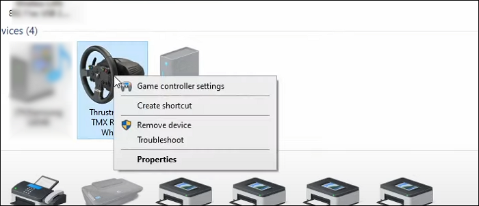

Alternatively, open the normal Control Panel on your PC, and select Hardware and Sound. Click on Devices and Printers. Under the Multimedia Devices, you will see the Thrustmaster device you have connected to the PC. Right-click on it and select Game controller Settings.
It will open the Game controller settings. Click on Properties to open the Thrustmaster Control Panel.

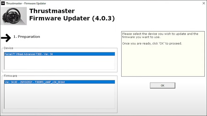

4] Update Thrustmaster device firmware
The Thrustmaster device comes with firmware that interacts with your PC for its proper functioning. If there are any issues with it, or outdated, you need to update the firmware. This method also helps when you can access the Thrustmaster Control Panel, but the settings you change are not affecting the device.
To update Thrustmaster device firmware,

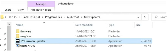

- Locate the Guillemot folder in the Program files in Local Disk C and open it
- Click on tmfwupdater folder
- Open TMFirmwareUpdater application
- Your device and the current firmware version running are shown in the Thrustmaster – Firmware Updater window. Click OK to proceed with updating firmware.

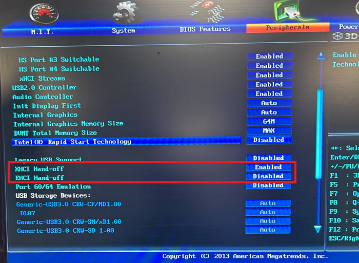

5] Tweak EHCI Hand-off and XHCI Hand-off modes
EHCI and XHCI Hand-off modes define how your computer’s BIOS interacts with USB controllers like USB 2.0 (EHCI) and USB 3.0 (XHCI). You can access these settings in the BIOS. To access BIOS, shut down your PC and restart it. While it is booting up, press F1, F2, F10, etc. based on your device’s OEM, and enter BIOS. If EHCI Hand-off is disabled, enable it. If it is enabled, disable it. If the XHCI Hand-off is disabled, enable it. It is all about tweaking settings and how it works on the Thrustmaster device and its control panel. Find the right combination for your PC and the Thrustmaster Control Panel, and enjoy using the Thrustmaster gaming gear.
