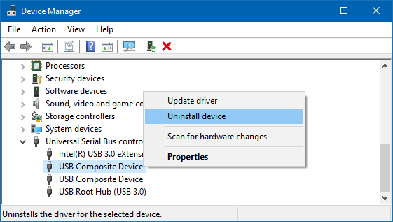

4] Reinstall the USB driver
Open Devices Manager from the WinX Menu and locate the Universal Serial Bus Controllers. Expand it to find the USB ports. Right-click and select Uninstall device and then repeat the same for all ports.
Now, restart the computer for Windows to detect and re-install the drivers.
