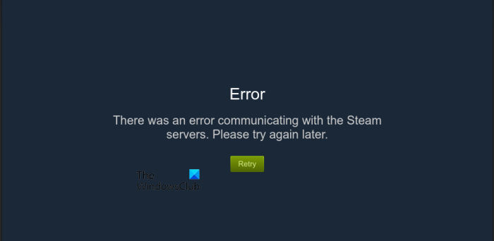

If you see the “There was an error communicating with the Steam servers” error message after launching Steam, you will not be able to play any games. There are multiple causes of this error, like internet connectivity issues, Steam server issues, bad Steam Browser cache, corrupted network drives, etc. In this article, we have listed some solutions that may help you fix the problem.
The complete error message is as follows:
There was an error communicating with the Steam servers. Please try again later.
When you see this error message on Steam, wait some time and check again. If the problem was occurring due to the server outage, the error would get fixed automatically after some time. If the error doesn’t go away by itself, restart Steam. The following steps will help you.

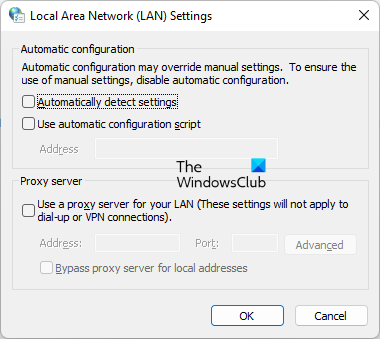

2] Modify the Internet Options
Turning off the Autodetect settings of LAN has fixed the issue for many users. You should also try this. The following steps will help you do that:
- Click on Windows Search and type Internet Options.
- Select Internet Options from the search results.
- The Internet Properties window will appear.
- Now, click LAN Settings.
- Uncheck the Automatically detect settings checkbox.
- Click OK to save the changes.
This should help. If not, try the next potential fix.

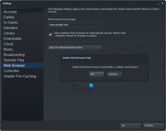

5] Delete Steam Web Browser cache
Sometimes the problem occurs due to bad or corrupted cache files. We suggest you clear the Steam Web Browser cache and see if it helps. The steps for the same are listed below:
- Open Steam.
- Go to “Settings > Web Browser.”
- Click “DELETE WEB BROWSER DATA.”
- Click OK in the confirmation window.
