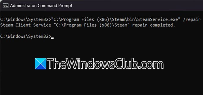

3] Repair Steam Client
If the Steam Client itself fails to launch on startup or when you try opening it manually, there is a high probability that the program has been corrupted. However, we can use a command to repair it. To do so, first open the Task Manager, and check if any process related to Steam is running, and if that’s the case, terminate it. Once done, open the Command Prompt as an administrator by searching it out of the Start Menu. Now, run the following command.
“C:\Program Files (x86)\Steam\bin\SteamService.exe” /repair
Do keep in mind that C:\Program Files (x86)\Steam\bin\SteamService.exe is the default location if you have installed it to a custom location, replace the location.
Once done, check if the issue is resolved.

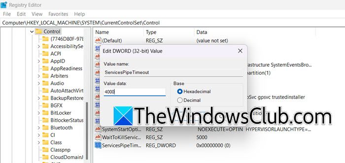

4] Increase Service Timeout
As mentioned earlier, in the Event Viewer, we found the following error message.
A timeout was reached (30000 milliseconds) while waiting for the Steam Client Service service to connect.
This means the Steam Client Service is taking more than 30 seconds to start or respond, which may have caused the error we are facing. Therefore, in addition to performing the troubleshooting methods mentioned earlier, we will have to increase the Service timeout by editing the registry. Before that, go ahead and backup the Registry.
Once done, open the Registry Editor and go to the following location.
HKEY_LOCAL_MACHINE\SYSTEM\CurrentControlSet\Control
Right-click on the empty area and click on New > DWORD (32-bit) Value. Now, set the Value data to 4000, which is 4000 milliseconds.
Finally, save and reboot the system.
