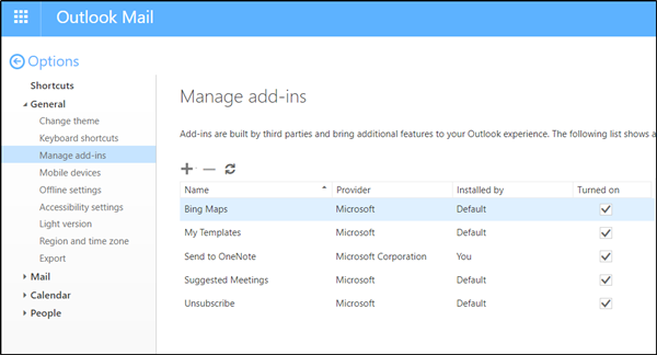

1] Check Outlook add-ins
If you find that an add-in that has been installed is causing a problem, disable it. For this, in Outlook, go to File menu >Manage Add-ins. This action will open ‘Outlook on the web’.
There, under ‘Manage add-ins’ check the ‘Turned on’ column for the add-in in question. If it is enabled, simply uncheck the box marked against the add-in.

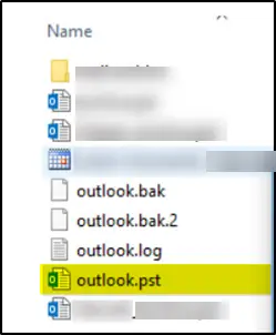

3] Enable Reminders Support for pst-file
If all the above methods fail to work, you can use this method as a last resort.
Enabling reminder support for a pst-file is simple. To enable reminder support for the pst-files; open pst-file by choosing the ‘File‘ menu > Open & Export > Open Outlook Data File.
Right-click on the top of the pst-file and choose ‘Data File Properties’ option.
When the new window opens, switch to ‘General’ tab and check the box marked against the following option- ‘Display reminders and tasks from this folder in the To-Do Bar’.
Restart Outlook and see if the problem is resolved.
