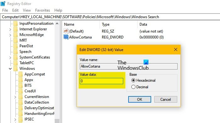

7] Check if Cortana is enabled
Cortana is an assistant, a virtual one, but still an assistant. It looks after your system, extracts information to make it work more intelligently, and does all this seamlessly. However, sometimes, it can conflict with your program. And for many users, it is interfering with the Steam client application. Therefore, you should disable Cortana in order to resolve the issue. To do that, we will use Registry Editor.
Open Registry Editor by searching it out of the Start Menu. Then go to the following location.
Computer\HKEY_LOCAL_MACHINE\SOFTWARE\Policies\Microsoft\Windows\Windows Search
Then right-click on the empty space and click New > DWORD (32-bit) Value. Name it “Allow Cortana” and set the Value data to 0.
Finally, restart your computer and reopen Steam to see if you are still seeing the Bootstrapper error.
