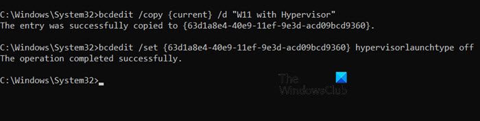

3] Use two separate instances to boot
If you do not like either of the methods mentioned above, let us discuss a permanent solution. To make the process seamless, we can create two separate booting instances—Win 11 with Hypervisor and Win 11 without Hypervisor.
So, first of all, open the Command Prompt as an admin and then run bcdedit to know the start of your hypervisor.
If the ‘Hypervisor’ is ‘ON’, run bcdedit /copy {current} /d "W11 without Hypervisor". But if it is disabled, run bcdedit /copy {current} /d "W11 with Hypervisor".
It will generate a string that you need to copy and paste somewhere as it is a new boot entry and is added to the list.
Now, run the following command to change the state of that boot entry to OFF if it’s ON; to ON if it is Off.
bcdedit /set {copied-identifier-value} hypervisorlauncher off
bcdedit /set {copied-identifier-value} hypervisorlauncher on
Make sure to replace the value ‘{copied-identifier-value}’ with the string value we asked you to copy earlier.

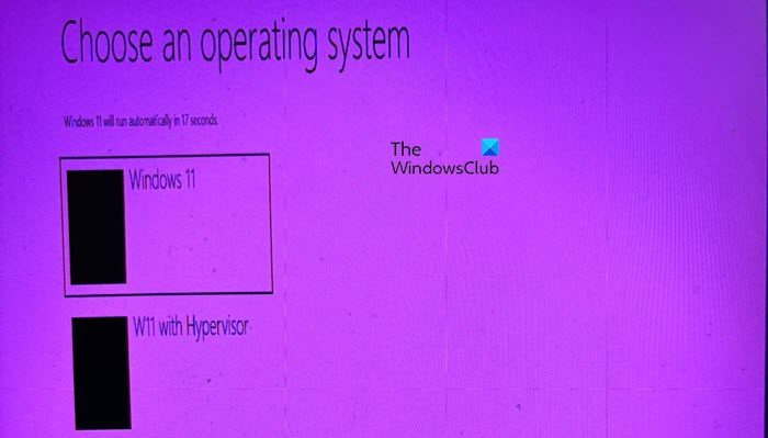

Now when you restart your computer, you will be asked in which boot instance you want to log in.
That’s it!
