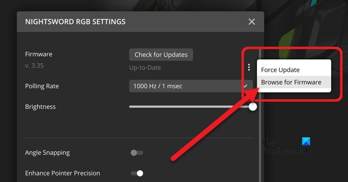

- Download the zip files, cut off the Internet, and now plug the K100 RGB through a wired USB.
- Launch iCUE, navigate to its settings, and switch the polling rate to 1000hz.
- Select the Check for updates option present beside the firmware name, and the Failde status will appear on the screen.
- Select the three vertical dots menu > Browse for Firmware, and then navigate to the zip files download folder.
- Now, double-click on Firmware 1.zip and click the Update Now button. Once done, close it, and again check Check for Updates.
- You will again see the Update Failed status, so click on the three-dots menu> Browse for firmware > click open Firmware 2.zip > Update Now. Once done, close this and repeat the same process except select Firmware 3.zip, and update it.

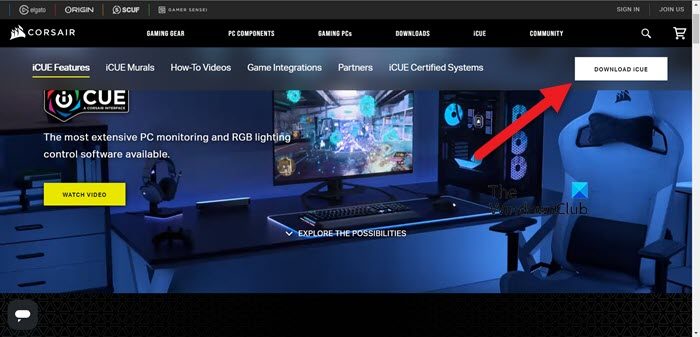

So, go to the Search bar, search, and open Device Manager. Select Human Interface devices, and then Corsair composite virtual input device. Now, right-click on it and click the Uninstall device option, and follow the on-screen instructions to uninstall it. After this, visit the official iCUE site that is corsair.com, and go to the Download iCUE option available in the top-right corner.
Once downloaded, open it and finally click the Repair the application option. After that follow the on-screen instructions, restart the PC, and this way, you won’t face any related issues.
