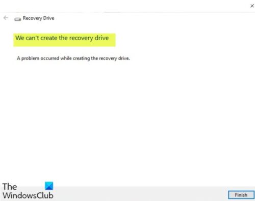

If when you attempt to create a recovery drive using a USB drive on your Windows 11/10 computer but receive the error message – We can’t create the Recovery drive, A problem occurred while creating the recovery drive, then this post is intended to help you. When you encounter this issue, you’ll receive the following full error message:
We can’t create the recovery drive
You might encounter the issue due to one or more (but not limited to) of the following known causes;

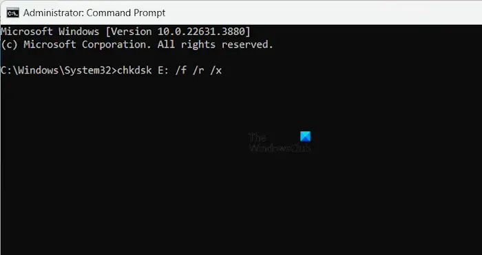

1] Check & repair USB drive errors
In the case that your flash drive has been used for several years and was formatted many times, it’s necessary to check its health state and try to fix the bad sectors on it if found any.
Do the following:
- Press the Windows key + R.
- In the Run dialog box, type cmd and then press CTRL + SHIFT + ENTER to open Command Prompt in admin/elevated mode.
- In the command prompt window, type the command below and hit Enter. Here you should replace E with your drive letter.
chkdsk E: /f /r /x
Afterward, try creating the recovery drive again and see if the We can’t create the recovery drive issue persists. If so, continue with the next solution.
