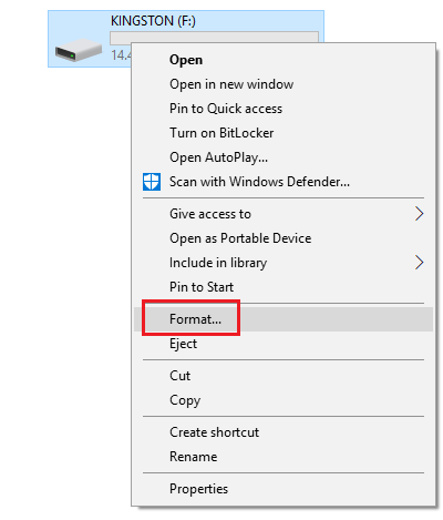

7] Format your USB as exFAT rather than NTFS partition
Formatting your external media will remove all data in the drive.
USB drives formatted as NTFS could be problematic for some Windows systems. The resolution is to reformat in another File system.
Right-click on the USB drive and select Format.
In the Format window select exFAT as file system and click on Format.
Try ejecting the media now and verify if it helps.
