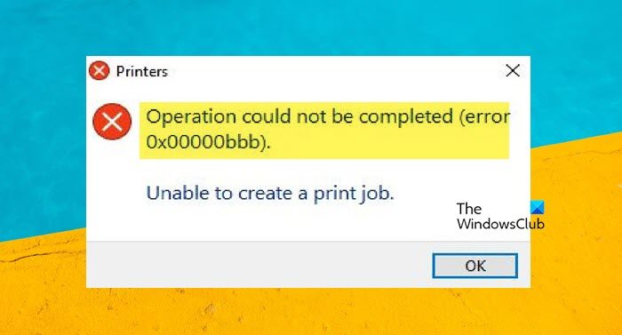

Some Windows users encounter Printer error 0x00000bbb, Operation could not be completed on their Windows computer while creating a print job using an installed printer. This issue is especially aggravating if you need to print something quickly. It seems that this issue occurs when Windows cannot recognize certain printers. In this tutorial, we will learn how to resolve this issue.
Operation could not be completed (error 0x00000bbb), Unable to create a print job.
Fix Printer error 0x00000bbb on Windows PC
This issue may occur due to several reasons. Some common causes of this error are outdated printer drivers, incompatible printer settings, damaged system files, or if your PC is trying to use the WSD port. Moreover, incorrect printer configurations in the Print Settings menu may also create an issue. Since there are various reasons, we recommend you start executing solutions in a systematic order. However, before making any move, it is important to check your computer for updates sometimes, just the act of updating can resolve the issue. If updating is to no avail, in order to resolve Printer error 0x00000bbb, execute the following solutions one by one.

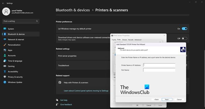

4] Add a new Port
Web Services for Device Port is a logical port that uses IP to connect to external devices such as Printers. However, they should not be used in this situation, and guess what, Windows is trying to use that port for managing your printer. In that case, all you have to do is add a new port and add the IP address of your printer. Follow the prescribed steps to do the same.
- Open Settings.
- Go to Bluetooth & devices.
- Select Printers & scanners.
- Scroll down and select Printer server properties or Print properties.
- Go to the Port tab and click on Add Port.
- Double-click on Standard TCP/IP.
- Click on Next and add the IP addresses of your Printer.
- After setting up your printer, open Command Prompt with administrative privileges.
- Execute the following commands one after the other.
cd C:\Windows\System32\spool
cacls.exe PRINTERS /E /G administrator:C
After executing these commands, check if the issue is resolved.
